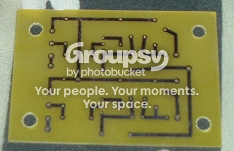

I had more on my plate this weekend than I realized so I only got to assemble the B1 Buffer to testing stage. I graded the 12 x 2sk170BL's and got two pairs that were very close to the 10ma that Nelson recommends. So far I have run it connected to the PSU I built and it works fine. No hum or noise at all.
I did make one change, there is a 10uf cap at output of the 2sk170, Nelson Pass recommended using a polyester. I hate polyesters so I put in a 10uf Nichicon Muse ES and a 0.1uf polypropylene bypass cap. Using just an Electrolytic with the bypass cap is better than a polyester IMO YMMV.

There's a board for the J-fet BOZ? Ordid you make it? If so lets see a mini tutorial! (on the BOZ board particularly) Nice little power supply!
Russellc
Hmm mini tutorial. :scratch2:
First off I make the PCB design in ExpressPCB and printout the bottom copper layer onto Glossy Inkjet paper using my laser printer at work. The bottom copper layer prints out the right size automatically and doesn't need to be reversed.:
I copy the silkscreen to the clipboard from the Edit menu and paste it into Paint so I can reverse the image, if not it's back to front. You have to scale it to the correct size before printing though, you can print it onto regular paper to get the size right first before using the Glossy paper.
Get the right size copper clad or cut a piece to size using a hacksaw. Always cut or drill while using a mask. Use a green scouring pad with some Ajax/Comet on it to get it shiny clean. Using a steam iron, turn off the steam and set to the hottest setting. Iron on the printout for the bottom copper layer first pressing down fairly hard, I take 2 - 3 minutes and let it cool. Put it in some warm soapy water for 15 minutes which will allow the paper to peel off easily. Run the copper clad under warm water and rub it gently with your fingers until all the slimy glue stuff from the paper comes off.
Check your design and touch up any missing bits with a BIC permanent marker there better than Sharpies for this.
I use Sodium Persulphate etchant, you can buy it online, I get mine from Frys. Mix 2 or 3 heaped plastic teaspoonfuls in a plastic dish with enough hot water to cover your copper clad, be careful, wear rubber gloves and eye protection.
Put the copper clad in face up and let it sit for ten minutes then start to slowly agitate it so there are little ripples on the surface, do this every few minutes until all the bare copper is gone. Dispose of the solution carefully, don't throw it down the drain or let it come into contact with metal. Only use plastic containers for it.
Wash the copper clad thoroughly wearing rubber gloves and let it dry. Drill the holes. I use Carbide bits in a rotary tool press, 0.75mm for resistors, 0.85mm for larger capacitors, 0.95mm for diodes and 1.1mm for leads.
Once done you can clean off the black toner with the scouring pad and Ajax/Comet. Once dry you iron on the silkscreen to the other side, line it up using a bright light, it's easy. Put it in the soapy water again for 15 minutes and wash and clean the sticky glue stuff off under warm running water.
Now your ready to go.

Hypno, your tutorial on etching makes this seem too easy, I've got to try this!
Yeah, the B1 is basically a disappearing act, no coloration and good detail. If you haven't built one, the F5 amp should be on your list for projects. The B1 and F5 are like peanut butter and jelly.
The secret is using Glossy Inkjet paper and it must be printed with a laser printer, you should also set the printer properties to Glossy paper as well. I cut it into 3 pieces and use the envelope slot on the laser printer. Then select bottom copper layer and envelope as the paper size. That way you get 3 printouts per sheet of paper.
