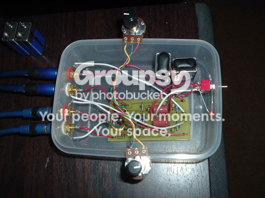

I took the Simple Preamp and did as I said, removed the two 1k5 input resistors. Changed the feedback loop resistors for a pair of 10k / 8.2k on each side. Then I removed the old ratshack 100k dual pot and put in the two 25k pots I was using for the BI Buffer Preamp and viola.
Here it is the all singing and dancing Super Simple Preamp with less than 20 components on the board.
It has an AD823 in it but a OPA2134, LME49720, LM4562 or just about any two channel op amp will work IMO. Maybe even a twin single channel op amp version would be good. Depends what sort of sound you like.
The new pots made a world of difference the gain is about right and can be easily adjusted by changing out the 10k / 8.2k combo, you can either increase the 10k or lower the 8.2k.
It has a slightly warm tube like sound, that I attribute to the AD823, that you could listen to for hours and never feel you are missing anything, the detail and sound stage is first class.

Using just the pots in a passive setup, no, I have heard that a passive setup up "sucks the life out of the sound" not sure if this is true or not. But that's why I went active.
I could just remove the batteries and the op amps then run jumpers from the output of the pots to RCA + output jacks? To see what difference I have.

Okay I got home and made some short leads with alligator clips on each end and removed the op amp and batteries. I connected the wiper of the pots to the + output RCA's so the signal was only going through the pots and there was still the 100k loading resistors at the outputs. So basically what came in went through the pots and out again.
I was surprised by the sound it was bassy, clean and very clear, however the 3D sound stage had collapsed inward, and the upper mids to the treble seemed thin, it sounded recessed and flat. Even though the detail was there, something was missing. It was like some of the life was gone.
I then put it back the way it was and everything was back in balance, it sounded more musical, the 3D sound stage was back.
So IMO it sounds better with the simple preamp as is than with just the pots and loading resistors.
