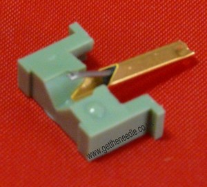

I just scored a 1226 Dual TT for 50.00 yesterday from the tech shop working on my Sansui 8080.
“One owner” it was his brothers. Not original dust cover but looks nice either way. I played 3 records on it so far after he told me to lock the arm down and hit start to reset it after travel.?. I has a shure N72EJ cartridge and a green 72EJ stylus on it.
It played the first album fine. Second album has like less than 10 plays and it skipped and moved on. Album this morning a original press Fleetwood Mac Rumours it got stuck and kept skipping.
I have not changed any settings yet. Here are some pictures. To help me please.
Was the turntable in use before you bought it? If it sat for a long time, it might need a thorough cleaning and relube before it'll play records correctly. Also, looks like your anti-skate is set to zero in the pictures.
I'd check the VTF, too. Too light, it might skip. Do you know how to set VTF on the Dual arm? If not, there are tutorials on You Tube.

Dark green stylus grips are for 78's, light green stylus grips, such as the op's are medium compliance .4 x .7 mil tips
for 78's ...
