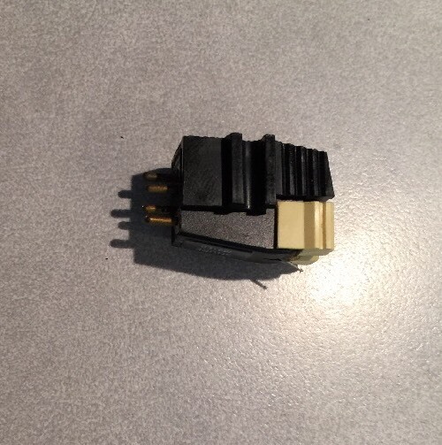

Took some piccies for context of the above to explain the "head broken off" (you can probably hear I do not know the correct terminology!).......incl a spread of the orig documentation as a FYI. Thoughts on the damage? Is the 1219 a good model? Before this damage ran like a dream......my Dad seriously looked after this one. Was 100% mint! A job worth doing?

It's definitely worth restoring and the damage is not that bad. I would start by very carefully removing the cartridge sled from the head-shell and then remove the cartridge from the sled...
https://www.vinylengine.com/turntable_forum/viewtopic.php?f=18&t=56219
It looks as though the cartridge "body" and the cartridge "housing" which is attached to the sled came apart which is also an easy fix. It should look like this...
You will need a small-wattage soldering iron. Using an entire replacement arm might be easier than replacing the magnesium head. Your unit is an example of the earliest 1219s. The arm was soon re-designed with a bit more meat where yours broke, as well as a change of bearing design. But everything is interchangeable. The arm rest, though was widened a hair for the beefier head.
Because it was your Father's, we will make that super extra effort to get it fixed.

I have been fixing up 1219s this spring. One had similar damage to its arm. The end part that the headshell mounts to broke off. I got a "parts" unit that the arm looked like yours off EBay. The wires are attached to a very small circuit board that is attached to the end of the arm that your headshell attaches to. Since the wires were still attached to that little circuit board, I had a part unit worth trying to fix. I have the end of a arm that would fit yours. It's off a 1229. Did one off a 1229 and fixed the 1219. You can have it, if yours can be fixed. The arm tube looks Ok from your pics.
Here's what I did. First, the end of the arm is held on by one screw. I removed it with a stubby small driver. Next I flipped it over. Labeling where the wires go. Unsoldered the wires underneath. GENTLY pull wires from the top end of the arm.
Be careful not break wires on the tiny circuit board. Now you can place the arm piece on the tube. Reinserting the piece I can send you. Thread the wires through it and and into the arm tube. Resolder, using a small soldering iron mentioned by Seth (Notransistors). Looks like the Shure cartridge is unharmed.
