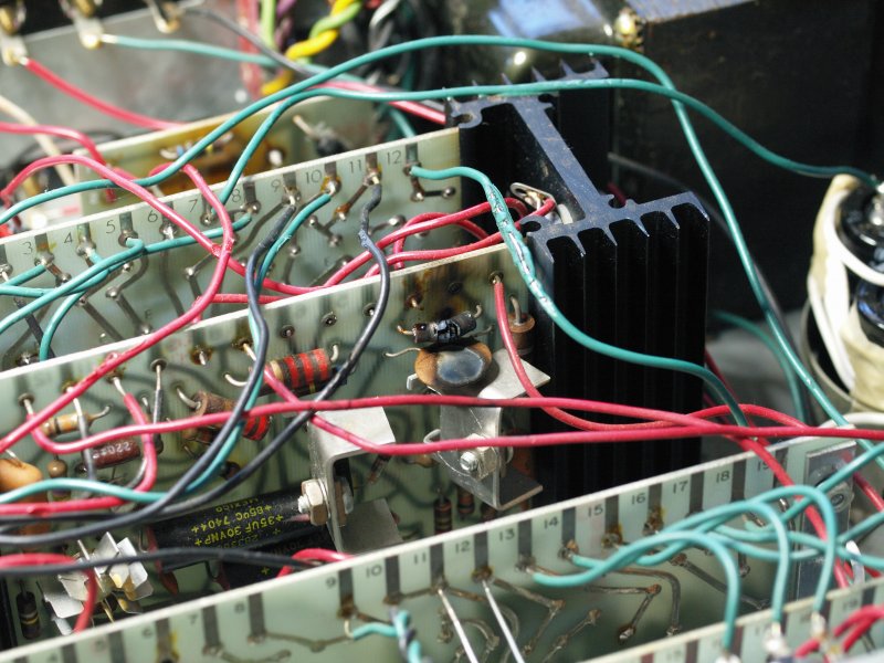

On the last stay of our summer vacation my wife alerted me to the fact that there was a strange electrical smell accompanied with a puff of smoke from the area of the amp. The amp was still powered on but instead of wonderful music there was a loud higher pitched hum. I switched it off and no doubt the smell was coming from the amp.
I opened up the case and found what I think is a blown resistor on one of the PC-18 boards + a very loose green wire with a partially melted casing and a scorched thingy under the resistor. I know a little about the inner workings but that's as far as it goes.

If you are keen to pursue fixing this yourself it would be wise to download a schematic and find out what major component is "near" that resistor. It has blown for a reason. It appears to be the last component for a major connection going from the board (or the first component for a major connection coming in). If its the former, the red wire adjacent to that resistor could be going out to the power transistors on one channel? Meaning you have issues "downstream" - ie: one or more blown outputs.
Curious if you ever got this issue fixed. Mine started frying this exact resistor on the PC-18 board. Still trying to figure out what the cause is with no luck.
