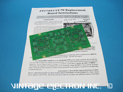

This driver board is close to "stock". Read the description for more information.
That's a good suggestion. The original driver tubes are getting harder to find good ones and are expensive. The supply is drying up.
Even though the 6GH8A's aren't made anymore like the original 7199's, the 6GH8A's are still plentiful and plenty to choose from. Some just use a tube adaptor, but the replacement board will look better without the adaptors sticking up from the board. Plus you will be using all new parts.
The other advantage to a new board, you aren't dealing with early 60s fragile phenolic boards. They can be dealt with but unless you are careful its real easy to have the traces lift or rip.
Exactly my thinking.
Vintage Electron has the proper inventory and if I ever restore another ST70 I will use this board.
Check out their site... I've bought parts from them for my Sound Valves equipment.
I used their 6GH8 board in my covid year project '70.
