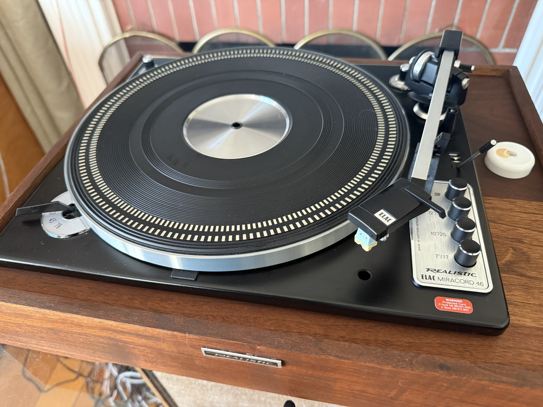

Needed another turntable about as much as another pair of speakers, but couldn't let this 46 go . I"ve owned several Miracords over the years, but not a 46, and this one was too clean to pass up. With original dust cover and manual to boot
