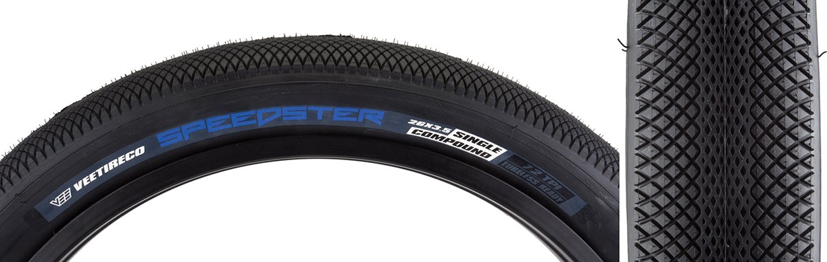

Depends where you ride of course, but I understand the Vee Speedsters are a popular option. Already have those on my wish list.
Dual patterns with more rubber in the center ribs where you'd expect most of the wear on hard pack, but with an open tread on the sides for softer terrain. Sounds like a win/win, and they're a whole lot quieter than the knobbies as well. They're 3.5", so you do lose a bit of width and may have to replace the tubes as well, but the RadRover comes with tubes that are rated to fit these tires as well. Nice planning on their part.
One biggie ... mfgs use thinner rubber to keep the weight down on this big balloons, which makes them easier to puncture. I'd say adding kevlar tread liners is almost a must if you do much side of the road riding. Basically just stick them inside the tire between the carcass and tube. On the bright side, the fatter tires are flexible enough you can pop them off the rim enough to patch a tube without having to remove the wheel, so no great down time, and an easy side of the road repair. A simple patch kit and pump are all you need.

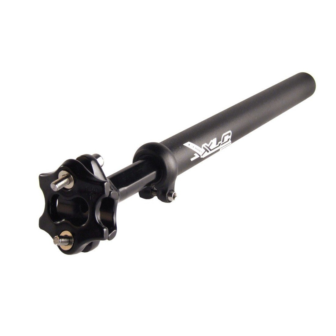

Good suspension as is, but I also have one of these on the old wish list:
Gives you a couple inches of adjustable travel, and a simple swap with the stock post.

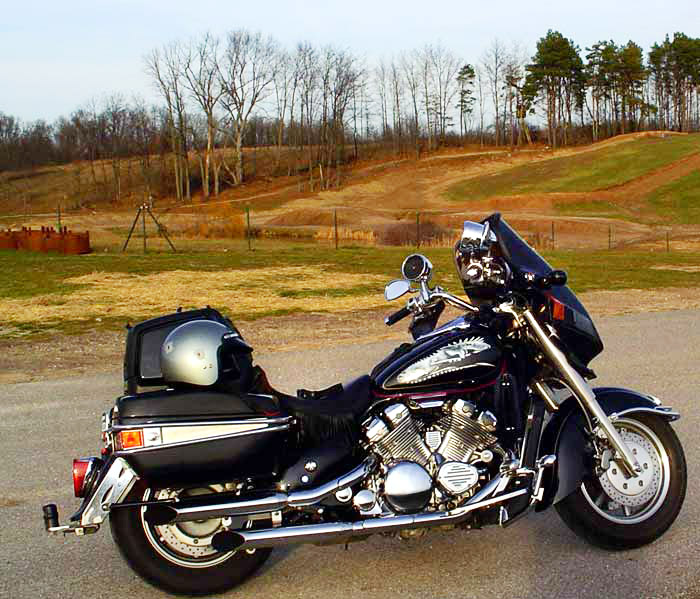

PS ... soft isn't always best. I had an overstuffed saddle on the motorcycle that would be nasty after a couple hundred miles. Swapped out for a Corbin which felt like a rock when I first got it, but didn't take long to find out the miles just rolled away on it.
