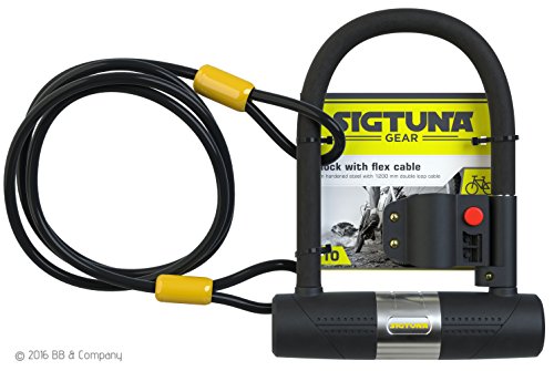

By the way ... what's everyone using for bike locks? I know they're all pretty much a crapshoot when it comes to stopping a pro, but I figure it's not a bad idea to be able to head off the opportunist.
Just ordered one of these ...
Cable's long enough to catch a tree or some such as well. It's also got a frame mount for storage. $40 at Amazon ...
:thumbsup: That's the best style of lock--the cables and chains are easily defeated. Cyclists and even former thieves recommend these locks, as they are difficult to defeat.
I plan on getting one later this year. On my "good" bike, I rarely ever ride anywhere that I would need to leave it locked up--it is usually out and back on the trail. But for now I still carry a thick cable lock with combination just for short-term use, until I get a Kryptonite. There is a less expensive version I have been looking at, but I may just spring for the "New York/Fahgettaboudit" version that has the double locking cylinder and an 18mm hardened shaft. Pricey, but if I ever decide to upgrade the bike, might as well be safe. And on this one, you need to buy the cable separately.
It is made for use around the frame, and the cable to secure one (or both) wheels. As I've seen it described, secure the most expensive part of the bike (the frame) followed by the second (the rear wheel) then the third (front wheel). And, to buy this type of lock so that it fits snugly, giving little room for thieves to work on trying to defeat it. If anything, they'll see our locks and go find an easier target.
Yup ... discouragement is a good thing in this case.
Something else I've seen bandied about ... keep any cables as short as possible and tight to the frame to give them little or no room to get a cutter on them. Little trick I've seen is to wrap the cable around frame members where possible. Still leaves a pretty decent section open between the front wheel and frame though, but if you twist that as well, there's less chance of cutting it. That's also where a flexible cable scores additional points.
I'd think protecting the front wheel would be a big thing, especially if it's a quick connect. Can't imagine why I'd want to remove the wheel while on the road, and if I do travel, it'd be on an outside rack anyway, so I'm not worried about fitting it inside. I'll drip an email to Rad and see if they can recommend a regular axle mount. I know the earlier versions of the bike had that as standard.
