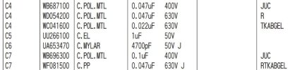

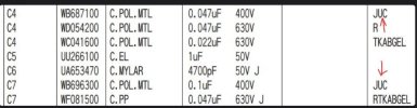

i can not zoom that schematic any more to clearly see the code next to c7 but the other 2 are clearly marked as polyester.
here are the codes
your parts list snip
being in arizona, i am assuming that you have the usa version.
they seem pretty specific on what they want and where depending on the electrical system.
weird how they are so specific yet do not specifically list metallized polyester. ( i am assuming metallized polyester. it COULD be metalized polypropylene but i'd bet they would call that pp.met)
mylar is a brand name of polyester so that's odd that there are 2 listings.
go with the value/voltage/tolerance that is installed in the board.
metallized polyester for c4 and c7 and mylar for c6 are what's called for.
