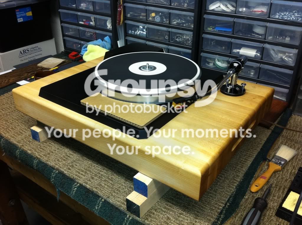

Here is my first attempt at a sort of home-made turntable, using the Empire 208 chassis and an Audio Technica ATP-12 tonearm.
I sanded the deck plate and motor/pulley housing, then painted them with a textured satin black. The platter was cleaned, polished and re-brushed. The piece of corrugated is just a template for the actual cover-plate that will be made from zebra wood. This conceals the holes from the former tonearm mounting area. The plinth (24 x 18 x 3") is from michigan maple block - to be stained to a darker tone. The mat is from Herbies.
You'll notice that I rotated the entire tt assembly 90 degrees, to accomodate the length of the AT tonearm (which is around 11")
Everything is just set in place right now, still lots of finishing to do yet.
It's an Audio Technica cartridge - not sure which model. It came with another turntable I bought some time ago. The headshell is also an AT. :)

Gorgeous! Great work, keep us apprised. How did you hollow out the plinth?
I used a Bosch 7 Amp Jigsaw with a long blade to cut through in the appropriate areas.

Excellent work. the cartridge looks like an AT14SA in the AT arm?
Correct!

You have a spare tonearm hole, eh? Hmmm, what to do with it?
Maybe a ...second tonearm? :scratch2:

I've read that the Pabst motor can throw a significant RF field so that may be why Empire placed the motor at the seven o'clock position. Serious grounding was recommended and you may want to put a shield around it.

Hmmm, Well, I guess I will find out when I give it a test run, although the motor is now further away from the cartridge, but indeed closer to the planned connection jacks on the back of the plinth. But, the plinth cut-outs encapsulate the motor, and the interconnect runs - so maybe it won't be a problem.
