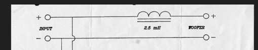

Looking back in the "past" the Klipschorn and LaScala used a single inductor to bring down the rising response of the
woofer. The Klipschorn folded path did a better job than the LaScala on it's own. (extra folds)
If you remove the 2.5mH coil the bass unit still sounded OK .

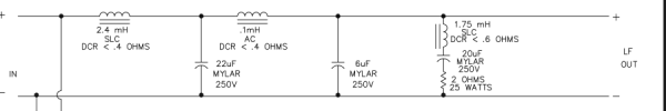

Then came the experiment to make a "better" bass unit, eventually named 1st gen Jubilee. The passive needed so many parts
I couldn't describe what was being done to the natural response of the two woofers used.

You have, from what I can see, used the back movement of the woofer to drive a passive radiator not a port. How did it measure without the DSP?
