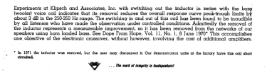

I always hear the amplifier has more control over the woofer with the electronic crossover. I see that PWK also was
aware of this. From Dope from Hope Vol 12, No 2 - Mar 9, 1972 Electronic Crossover.
Then it goes on to say the inductor was restored.
