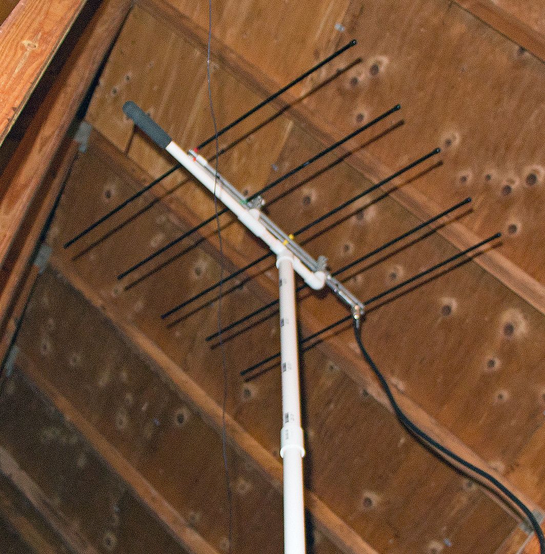

You need a roof antenna. Consider a Yagi in the attic if you can't place one on the roof. It's way better than any wire dipole for distant or weak stations. You can DIY one. :thumbsup:
DIY Yagi.

Its about the frequency of the station you want to listen to on your system. Most simple dipole antennae are tuned for 100 MHZ. A longer would would be centered for a lower frequency. My favorite stations are centered around 89 Mhz. So a longer dipole would be a better solution. But I have a 10 element antennae type yagi in the attic aimed for the stations I prefer. A good antennae makes all the difference in the world.
