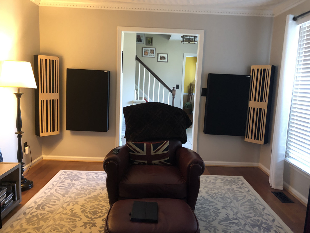

My first question is did you do some listening without the 3 rear panels mounted and if so
did it change in a beneficial direction?
Perhaps replacing with diffusers might be useful having that doorway unloading that end of the room.
Will be following further suggestions.
Hiya Rick. I have been listening for almost a year now sans rear panels. I have not listened with them there. I am working a lot and hope to find time after work tomorrow. The panels are not mounted. They are just raw foam leaning against the wall.
Yes indeed that area behind the couch is screaming for diffusion not foam. I like your point about the hallway.
Good diffusers are pricey so I am thinking of making one or three for that spot. I need to watch a few more DIY vids to determine which type I want. I'll have plenty of time this winter to put something together. Hope that you are well.

Added two more 244 bass traps to the room. They are now at the side reflection points and the other traps moved to behind the listening position as they have scatter plates inside.
Really happy with the acoustics in the room. Still lively but the bass is solid and tight.

That’s a great place to be if the source material is good and the electronics can convey the recording honestly. It’s the sonic landscape I prefer. Tight and authoritative bass with heft, a robust mid range and top end that has lively snap. The room has to be well tuned to get all this right. Looks to me like you’re there :beerchug:

Really enjoying the room. It's amazing how bass can obscure the sound if it's not treated.
Listening to albums it's clearer and I'm picking up sounds in the background that come through better than before.

For sure. I’ve found that clarity of low frequency content, the mid bass region in particular, is key to getting a dark background behind highly defined image resolution and inner detail. Sloppy bass is like too much sauce or seasoning on a dish...it overwhelms and conceals all the nuanced flavors.
Interesting dilemma. Since the latest acoustic purchase I've noticed that at higher volumes I'm now getting vibration through the listening chair.
The speaker stands also vibrate. They are filled and with spikes going through the rug to the floor.
I'm on a crawl space so I'm thinking maybe I need to isolate the speakers better.
I've tried with spikes up with no change.
The bass sounds excellent still so performance wise no complaints.

I wonder if a concrete 40x40cm garden paver and glue on some rubber feet or furniture pads (not scratch any un-carpeted floor) could assist? This is what I have done, it worked for me.
