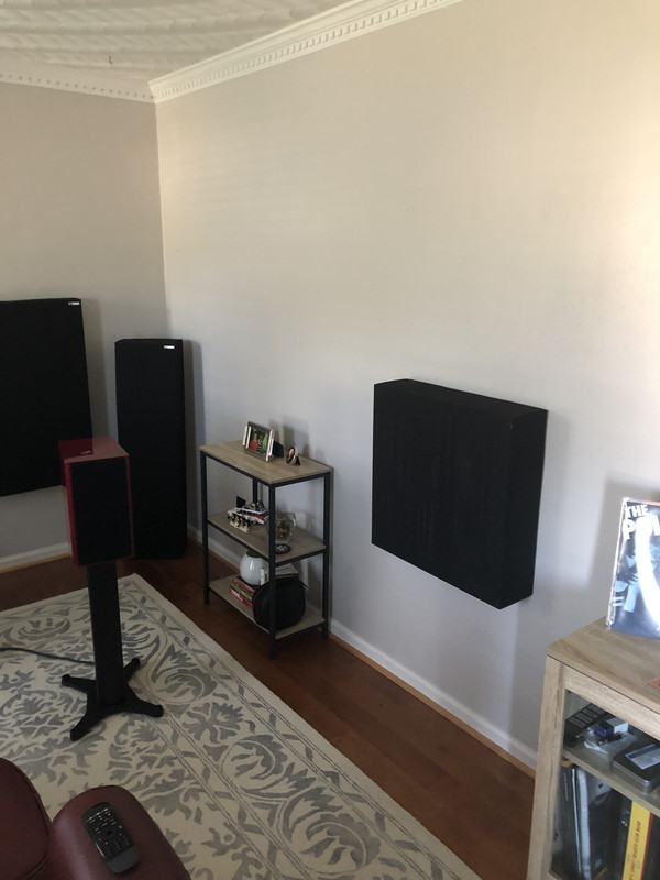

My dilemma now is do I buy two GIK 242 square panels for the first reflection points.
I can then move the square Alpha panels (the current 1st reflection panels) to the back wall and put the long skinny Alphas in the rear corners?
Would this be over kill?

I experimented again last night with the panels at 1st reflection. I put the plate back on with the cut outs vertical but didn't like it. It's hard to put a finger in what it was but it didn't sound right.
It later occurred to me that as they are square I can rotate it and they would be horizontal.
Bingo!
Much much better than without and vertical.
The one thing that stands out the most after a few days playing around with placement is how much bigger the sound stage is and most of all the black space.
Those quiet spaces in music are so important and have a huge impact.

Looking for some advise on my panel placement and additional panels.

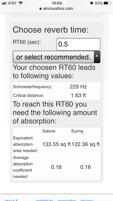

I did the RT60 calculator with the following results.

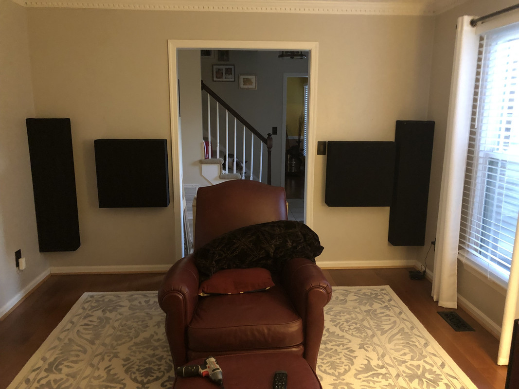

I have GIK panels as shown in the pics below.
I've played around with the placement and with what I have this sounds good.
According to the calculator I need 133 sqft. I currently have 44 sqft.

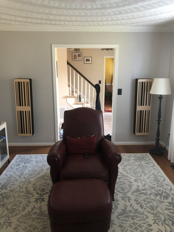

All the panels I have are bass traps. The two square panels have diffusers that I've taken off for now.
I'm thinking I need to get the 242 panels for the side reflections allowing me to put the square panels on the back wall and the skinny panels in the corners of the same wall.
Any ideas?
Don't forget to add floor/ ceiling coverage into your total. I don't know how thick your area rug is or if you have a nice thick pad under it, but if you put that much absorbtion on the walls I would expect a very dead room. Granted, the rug will not have the same coefficient as the rest of your traps, but it has a huge area.

I’m starting to think these online room treatment calculators are little more than virtual salesmen for absorption panels. ;)

Had an hour last night to experiment, moving the skinny Alpha panels to the front wall and found no improvement. Infact it muddied the lower range. I guess not having any absorbtion on the rear wall was the problem.
After reading through the Arqen site I think I need to deal with absorbtion first.
The plan is to get two GIK 242 panels for first reflection.
I will put the Alpha panels on the rear wall. The skinny panels will go in the corners to mirror the front wall and the square panels having the speakers.
All my panels are 6" thick so I think I'll be covered after this.
The second step will be to build diffusers for the front wall.
