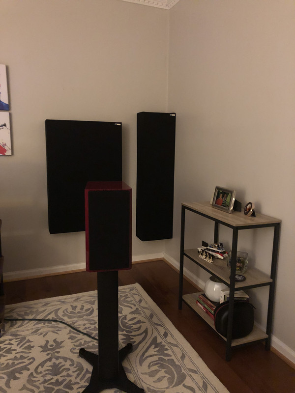

Looking for some advise on my panel placement and additional panels.
I did the RT60 calculator with the following results.
I have GIK panels as shown in the pics below.
I've played around with the placement and with what I have this sounds good.
According to the calculator I need 133 sqft. I currently have 44 sqft.
All the panels I have are bass traps. The two square panels have diffusers that I've taken off for now.
I'm thinking I need to get the 242 panels for the side reflections allowing me to put the square panels on the back wall and the skinny panels in the corners of the same wall.
Any ideas?

I mounted the corner base traps and tweaked the first reflection panels and I'm very happy with it.
Listening to Pink Floyd WYWH SACD and it's as good as I've ever heard it. Massive sound stage, crystal clear and great crisp bass.
Here's a pic of the mounted bass traps

I like what I see going on there, Ollie. Great looking room and rig. I’ll study your pics a bit more closely and respond with my thoughts when I have a little more time to do so. But first, have you tried draping a folded-up towel or blanket over the backrest of your chair? That high back puts it behind your head and the leather is acoustically reflective. Might be worth giving it a shot if you haven’t.

Very interesting about the chair if I will try that right now.
I tweaked the rear panels and have them facing directly in front of the speakers.

My dilemma now is do I buy two GIK 242 square panels for the first reflection points.
I can then move the square Alpha panels (the current 1st reflection panels) to the back wall and put the long skinny Alphas in the rear corners?

There's A LOT of misunderstanding out there regarding room acoustics and hifi...which is unfortunate and unnecessary because the fundamental concepts are not at all hard to grasp and treatment strategies not hard to implement. And then there's a contingent in the hobby who look at those who embrace the concepts and implement strategies to address room acoustics issues as snake oil consumers. There are several reasons for the deliberate denial of the science, but I don't think it's constructive to elaborate on it. Suffice it to say, I think the biggest problem is that most simply never get an opportunity to hear the improvements in system performance that are possible when a proper room treatment scenario is implemented. For those that do get that opportunity, their reaction is virtually always just like yours...not subtle and game changing.

I experimented again last night with the panels at 1st reflection. I put the plate back on with the cut outs vertical but didn't like it. It's hard to put a finger in what it was but it didn't sound right.
It later occurred to me that as they are square I can rotate it and they would be horizontal.
Bingo!
Much much better than without and vertical.
The one thing that stands out the most after a few days playing around with placement is how much bigger the sound stage is and most of all the black space.
