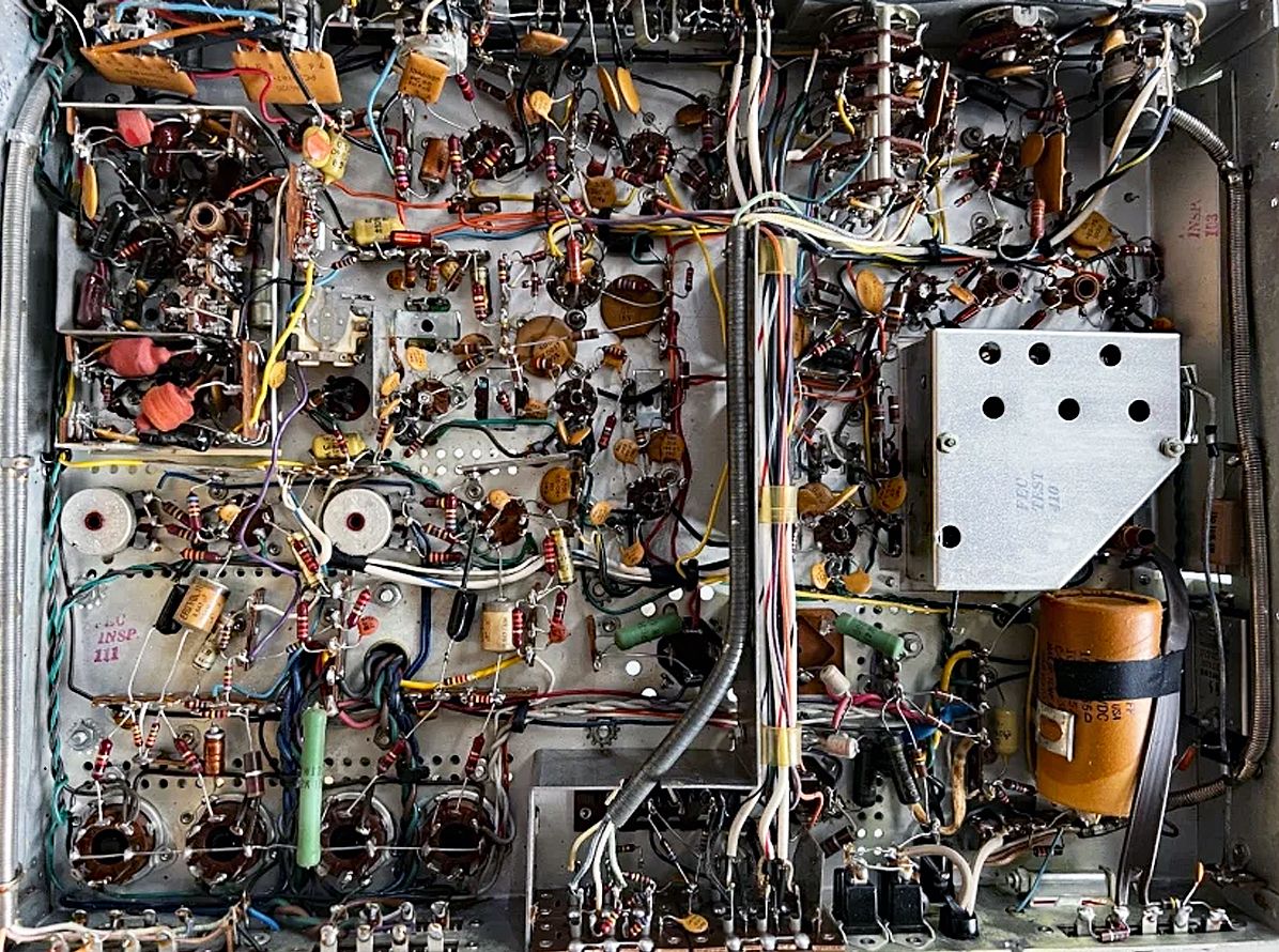

Pretty sure the bias cap has been replaced though, I see two modern blue caps under the deck where the old dual can would live. 35v, 2200uf seems like a reasonable sub for the original 35v, 1000uf parts. also frankly they don't make sense for much of anything else.
these don't have hum pots, it uses a pair of fixed resistors to ground
the others maybe, but equal in both channels just doesn't seem so likely to me.
The other big reason I question the caps is it sure looks like one of them is beginning to ooze.
the bottom of the can basically center of the pic. That should be the black one.

are you referring to this brown bulge in the middle of these 4 connection?
Yes. Regardless of 60Hz or 120Hz hum, the cap cans need replacing.

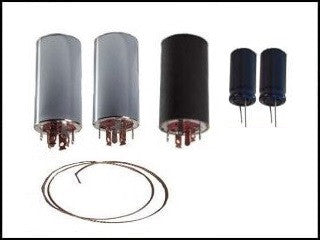

Electrolytic caps differ in construction versus non-polar poly coupling caps. You can buy individual electrolytic caps, but the cost will probably be the same as multisection cap cans. Plus, chassis space will become an issue unless you have the cans restuffed or use Hayseed-stuffed ones.
A list of some individual electrolytic caps.

yea. I can't absolutely guarantee just by looking at it that its bad, but I've never had one visibly leaking that was not electrically in bad shape.
The caps develop electrical leakage, make heat, and that makes pressure so the magic goo starts to come out through the vent that is present specifically to give them somewhere fail rather than exploding and launching metal bits all over the place.
has a drop-in set for this specific model. The two extra caps are for the bias supply which I don't think you need. Can probably contact them and get it re-quoted without the radial caps.

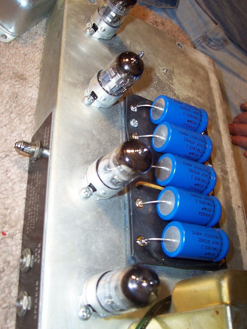

These companies should have done what Fender did, putting the cap under a doghouse on top of the chassis. Replacing these caps is so easy. :thumbsup:
Doghouse power caps.
Doghouse cover.
Space. Looks like a lot of open flat chassis on that Fender, not so much on receivers or honestly most hifi gear. Even the stuff that doesn't need to be cramped often is. I guess they were saving pennies on the steel in the chassis or something, but way too many things are just way more cramped than makes any sense. Makes them miserable to work on too.
