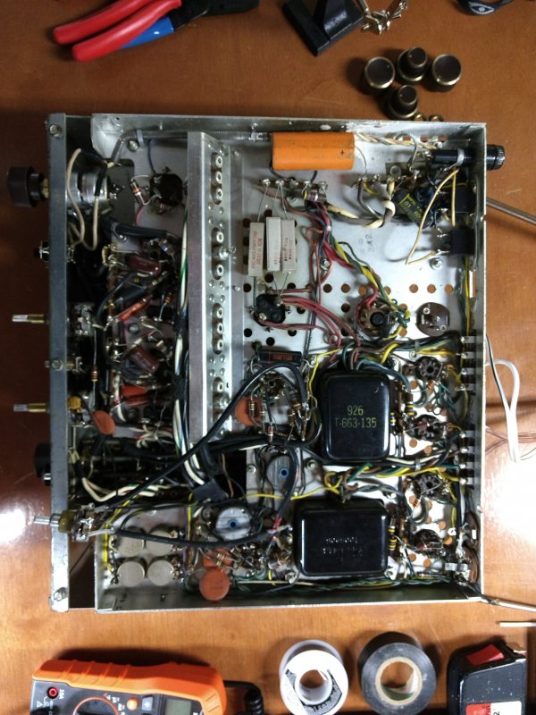

After additional inspection, the 100 mfd capacitor "C5" blew, as there is an obvious spray of white waxy residue in the inside of the chassis and on my desk emanating from the "+" end of the capacitor. This is in the circuit with the phono preamp tubes, so I am still not sure if the capacitor blowing is due to a miswiring, or due to trying to run it without the tubes. When the tubes were in, they started to glow like lightbulbs at the base of the tube, so something was wrong before I pulled them also, I guess.
The strange thing is that this capacitor still reads 100 uF on my multimeter. Is it toast? Or can I still use it?

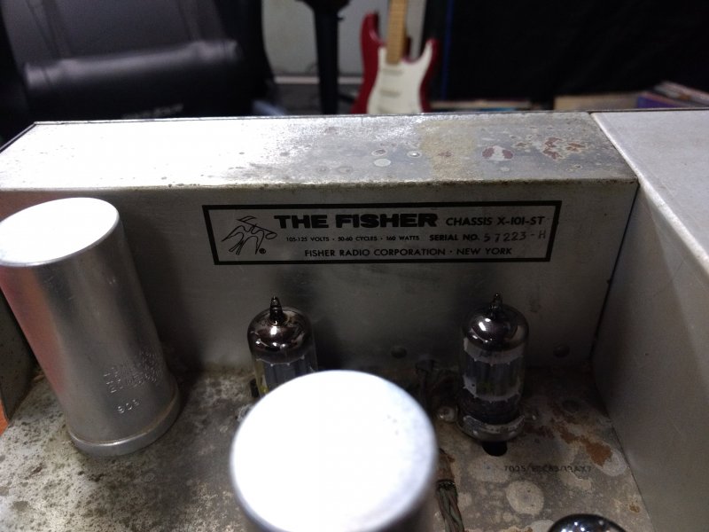

Your C-3, C-4, C-5 id does not correspond to electrolytic's in any of the X-101 type manuals that I have. The closest manual to the X-101-ST is for the EXECUTIVE V Console with the X-1000 which is the console designation for the X-101-ST. Suggest you look that one over.

Which manual are you using????? You need to use the EXECUTIVE V CONSOLE Service Manual for the X-101-ST. The console version is the X-1000. As there is NO X-101-ST manual available use the EXECUTIVE V MANUAL. http://www.fisherconsoles.com/executive V and VI.html And we need the serial @ off your X-101-ST. There are a couple of changes between the X-101 and the X-101-ST that are covered in the Executive manual.

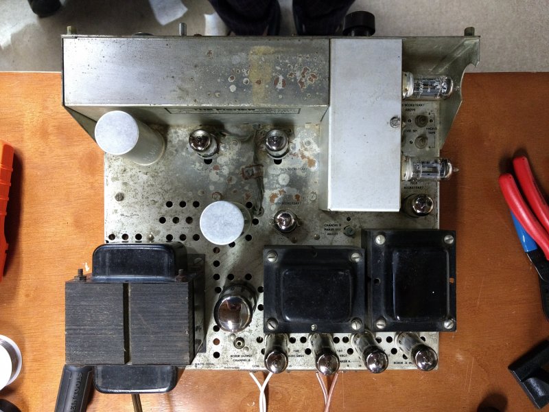

Can you take a couple of overall pics of top and bottom so we can positively ID this amp, please.

Thank you Larry, the Executive V makes a lot more sense, as there is a missing resistor in my amp, compared with the other two X-101-ST service manuals I've found (also linked in this thread). The manual I was using was really close, and I was unable to tell if the "minor" differences were the result of a wrong schematic or of modifications. The serial number of my amp is 57223-H.
The smoking resistor, according to the Executive V schematic, is C29 not C5. The main difference in this area, which was confusing me, was the absence of the 920 ohm resistor in parallel with this capacitor, which doesn't exist in the X-101-ST schematics - instead my amp (and this schematic) have a couple of composition resistors, a 10K and 6.8 K, instead. The Executive V is definitely the right schematic, and it seems despite the other modifications with power switch and loudness circuit, this part of the circuit is original.
