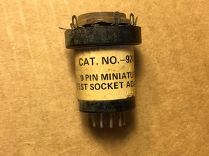

any chance you've got a set of those tube test adapters that bring the pins out topside? That would get you access without having to actually disturb anything.
I don't have the tube test adapters but I have socket savers I use with my tube tester. I probably could use them with a little fiddling around.
