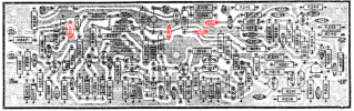

Hello AKers.
Have a Marantz 2245 where the front end of FM seems to be struggling - but I can't seem to narrow down a particular source.
Stereo FM isn't functional - stereo lamp is good - works in other modes except for AM. The tuner meter doesn't seem to particularly move as I run through the stations, but it does move. Volume is also quite low - but I haven't been able to isolate anything.
Unit has been deep cleaned with deox, power supply recapped, all inputs and AM sound great, issue isolated to FM only. Tuning gang has also been cleaned a couple of times along with the meter tune adjustment tweaked and returned to position to ensure it wasn't just a dirty connection.

I've traced through the IF section, multiplex section, and mute section and all voltages when tuned into a strong local signal - with an FM antennae attached - look perfectly normal.
The only thing that has stood out to me is on H553 - on the P550- muting board - the emitter should be at 0v, I see 1v, the base should be 0, and I see 1.6v.
I've attached a picture of the muting board voltages to see if anybody can provide any insight.
J554 and J559 both lead to the IF board and on the other side of the resistors they're tied to voltages are perfectly normal.

Replaced H553 on the muting board with no change - seeing 1.1v on base, 1.8v on emitter, and 12.8v on the collector.
Looks like it's being fed from the IF board from J207, I see the 1.1v that's driving the base on H215, a 1N60 germanium diode.
It tests fine in and out of circuit. H205 voltages are normal before it
H205
C - 8.1v
B - 4.2v
E - 3.2v
I guess I can just swap the two 1N60's and see if the issue follows.

Can you feed a strong RF SG signal into it and probe along the chain (H201, 202, 203, etc) with an O-scope and see where it drops out? Kind of like @PE9ZZ says above. Probably be before the signal is picked off for the strength meter.
There are no less than four points where you can measure signal level: C228, C230, C232 and C213. These four voltages are added to get the signal level indication. The last one is all the way at the end of the IF strip and oddly out-of-sequence. With a strong input signal all four of these points should produce several volts of DC. This test will quickly pinpoint the fault in the IF strip (if there is any).
There are no less than six ceramic filters. If one has gone phut they all should be replaced. And have the same color dot. As said above, just short in- and output of each filter with a small ceramic capacitor. 1 nF or more is fine.
I shorted all of the ceramic filters inputs and outputs and heard/saw no change, I presume this means they are okay, would there be an increase in signal or dramatic change when shorting these if they had drifted or been damaged over time?
I have around 18 or so ceramic caps on the IF board in the 2245. I only seem to see C213, which reads around 2.3v.
They never drift, they either work or go phut. If no change they're all OK.
Marked in red. It is extremely important to verify the four voltages in order to properly troubleshoot the IF strip. Make very sure you are presenting a strong FM signal, whether off-air, a cheapo MP3 FM transmitter or SG doesn't matter. All four voltages should be like the last one.
Having said that, 2.3 V across C213 is inconsistent with your symptoms (no tuning indicator deflection, low audio). Is H501 OK? DC-wise? C508?
