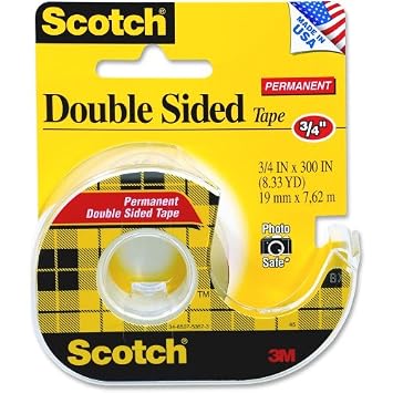

Here's a simple solution to make your counterweight heavier. Take the counterweight to a hardware store and select a stainless steel washer that matches the diameter size and hole of the counterweight. Use Scotch Double Sided Tape and tape the washer(s) to the counterweight! It's that easy! I did that to my SME 3009 Improved tonearm, works like a charm!! The counterweight will be closer to the tonearm pivot giving you better bass & tracking warped records! The counterweight looks really nice with the correct size washers added to it!
You can use the Scotch double sided tape to tape your unglued album covers!
