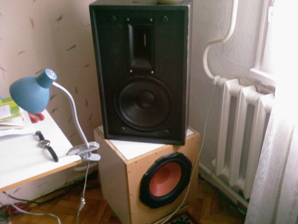

Another round of pics of other GAMMA speakers:
Here are the disco/home speakers with two GAMMA BK3013A woofers each.
And a top of the line GAMMA 100 speaker with the heavy weight BBK-131A AlNiCo midrange driver, two VLD's and a BK3013A.
Here is a three way speaker with the updated VVK-131B midrange driver.

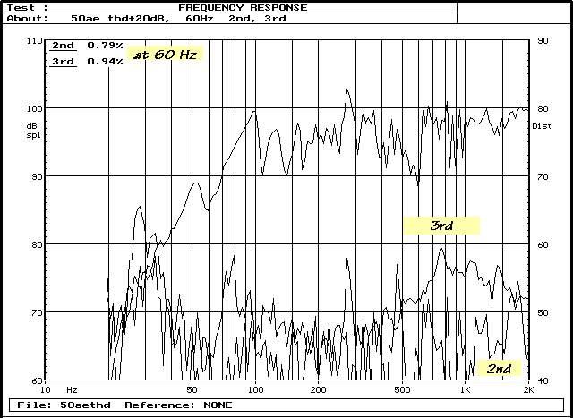

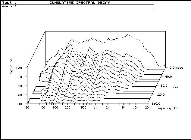

I haven't tested the LA1231's but I do have some data on them, should be enough:
full
full
full
full
full
full
full
full

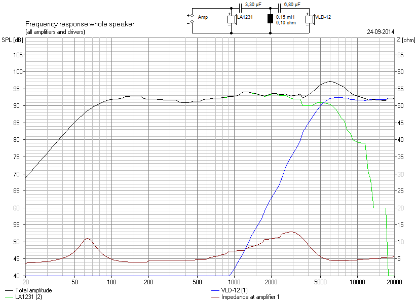

I used this data to make all my "assumptions" and it turned out fine.
The graph showing the crossover was done by entering data from these graphs into boxsim.
My speakers are 60 liters, I increased the box volume from 50 liters, to be more in the center of the range where two airflow resistors are used.
If I was to go small, I'd probably, go for 30 liters with one airflow resistor, this is just an assumption though.
