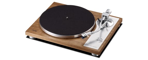

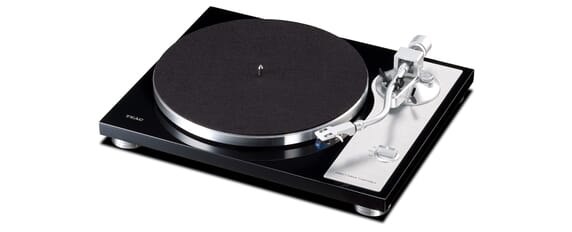

How about e new Teac?
I have liked the look of their TT's Music direct has the TEAC - TN-4DSE Direct Drive Turntable , In stock with either piano black or walnut.
Athanasios
I had looked at these and they indeed look nice, but can't find much info on TEAC TT's.
