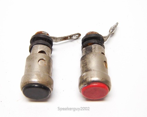

like I said, there is also a lot wrong with the speakers. The right tuning knobs are completely gone, there are screws lose, and to top it all off, the negative connector plug on the right is gone, so they’re gonna have to replace all that

Replace the push connectors or whatevewr with binding posts.. Easy to find o the bay or other online suppliers like
but not exclusively Parts express
Just remove the black moulding and the individual posts will easily replace the JBL push or twist connectors
I would do this, but this is my first time repairing speakers, and I would rather have a professional do it. I am not "handy" in any sense, and I am going to limit myself to refoaming the speakers. I will check this out in the future though, since It would be good to have more independence and save money on this.

Maybe your dad can help with the binding posts. They aren't too difficult, easier than the surround replacement.
Well, my circumstances have definitely changed. I opened up the 'non-working' speaker, and to my pleasant surprise, I found the tuner knob completely intact. It had simply fallen out of the case, and everything was in mint condition. better yet, I now believe that I can fix everything myself. I guess the dread of the task was worse after all. I will be ordering those banana jacks in the near future, and replacing the foam in the nearer future. I will keep yall posted with updates.
