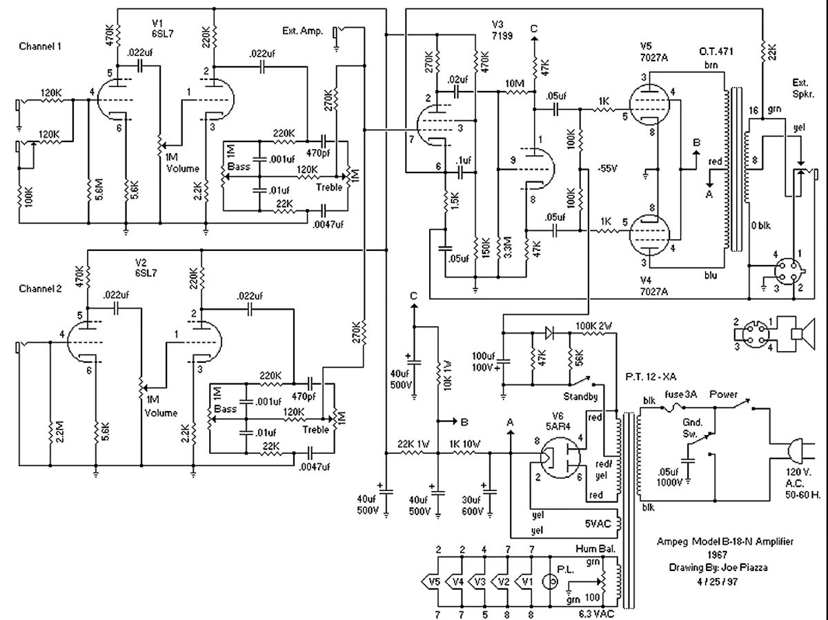

I don't know if you plan to gig with this amp, but a push-pull 6V6GT may not have enough beans. If you want to have a tube bass amp, maybe a clone of the flip-top Ampeg B-18N is a better choice?
A good bass amp needs to be clean. It needs hefty transformers. A front-end and output sections with good headroom.
I'd prolly go with solid-state power supply rectification. And you can use 7581A tubes in place of the harder-to-find 7027A.

This is a great suggestion! Itd be easy enough to use a diode bridge in place of a 5u4. I can strip down the chassis to sockets and start over to clone this B18N. Looks like maybe the 7581A will use the same sockets? Ill have to trade out the 12ax7 sockets for 6SL7 sockets but thatll mean more 12ax7s to roll in my fisher or 175 maggie amp. Ok I like this

You will need higher current-capable power and output transformers. A 7581A will work in a 6V6GT socket, but will draw more current and need higher plate voltages than a 6V6GT amp was designed for.

load impedance is probably wrong too. 6V6 are typically around 10K load, a 7581 or other 6L6GC class tube usually wants something closer to 6K. They can be used at higher impedance but it loses power, and you probably want to knock down the screen voltage so its not abusing the tube so much.

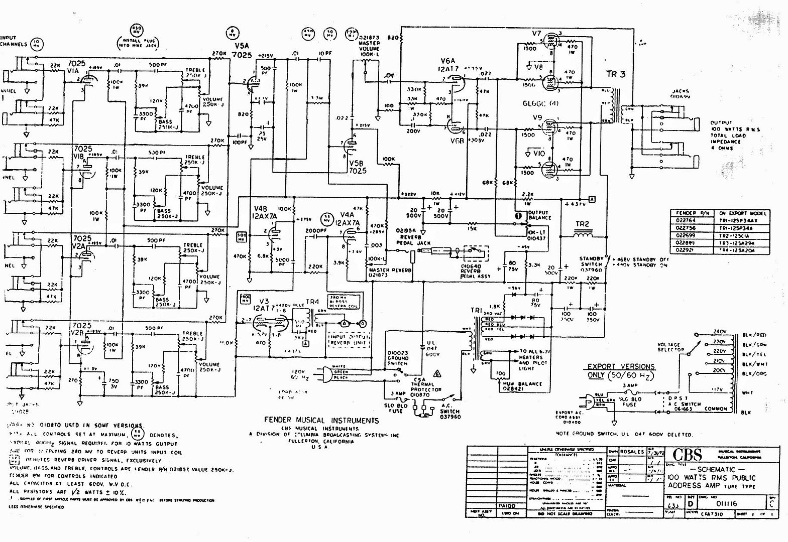

Restore a vintage Fender PA100?
