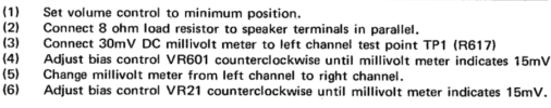

2) for biasing the Output the manual states the following:
The test points are on the schematic here:
My question is, where the hell is TP1 on the actual board? Is it the yellow and purple wire that seem to serve no purpose? When adjusting this should there be a load or not?

I will preface this with I don’t have a 930, and did not stay at a Holiday Inn Express last night. The instructions show that test point 1 equates to R 617. Looking at the scat, I circled in green the two resistors which equate to the test points for each channel. Scat also shows two circles labeled TP1 and TP2. Since the board isn’t labeled, and I can’t see the trace side, I can’t be positive, but one of the two in each pair of cement resistors the green arrows point to will be the correct resistor for each channel respectively. There are also two pins sticking out from the board, which I circled. Again, can’t see the traces and if they lead to one of those cement resistors, but those pins MIGHT be the test points shown in the scat, one pair for each channel. The bias trimmers are circled in yellow.

Test Point one is shown on your diagram, it is the leg of the emitter resistor R617, 5 Watt 1/2 ohm. To attach there you will need a mini J hook, be careful not to short something when you test, or you can destroy parts.

So, several things:
  1. Disconnect your speakers. No reason to risk them, no reason to keep them connected.
  2. Use a 10 watt or higher 8 ohm resistor instead of a speaker. Connect each of these load resistors to the speaker terminals as if they were the speakers.
  3. As @jheu02 points out above, attach your multimeter to each side of R617. If the two sticking-up metal rods at TP1 do, indeed, connect directly to each side of R617 (you can easily test with your multimeter's continuity setting or 0 ohms if you don't have that setting), set your multimeter to volts DC
  4. Follow step #4 to get as close to 15mV as you can. If you can't get there exactly, that's OK

Two R616? I think HK is known to have a lot of typos in their manuals during this era. It appears the first R616 is indeed R617.
And if you compare the above sm amp board to the earlier posted scat, the board shows TP 1 and 2 on the same channel and TP 3, 4 on the other channel. The scat clearly shows TP 2 is for the R channel, TP1 for the L channel. However, IF the traces as depicted are correct, the lower pin on each channel connects to the lower lead of R617, 637, and the upper pin is tied to the large pads that the other leads of each resistor tie to. So, you would attach your DMM leads to the two pins and adjust the corresponding trimmer to set the bias for each channel.
These are the pins you want to clip onto for setting bias. If some of the components are in the way, they can also be accessed from the other side of the board.
Note this board is from a 630 Twin, which is very similar to your 930 board.

Okay so if I’m reading all these posts correctly, my DC offset I shouldn’t worry about?
And my bias I’ll connect to tp1 and tp2 on the board and adjust each variable resistor while having an 8 ohm resistor in parallel with each speaker?
(I did put an 8ohm resistor on each speaker terminal but they got really hot so I removed them quickly)

To set bias, no input signal or speakers used, just two 8 ohm 50 watt minimum resistors hooked to one channel in place of speakers. The other speaker channel remains turned off. Selector set to AUX. Stereo switch set to stereo. Bass, treble, and balance set midway with volume turned right down. The resistors should remain cool.

Bought some 8ohm, 50W resistors and hooked them up to the speaker A terminals. With volume down, knob on Aux, and only the Speaker A selection switch activate I was able to use the two test pins on the board. The right side was at 17mV so I turned the pot to until 14mV was had. Yay!
However once I tried the left side, The potentiometer didn't seem to change much. It was mostly 0mV but it did have a small spot that let it be adjusted up to 3mV where it is currently at. For reference the receiver sounds beautiful, and the channel isn't dead or really noisy. But I did think it was kind of quiet.
Is this a transistor issue / short issue from when I was working on this board? (again it sounds great, just lacking a little bass if anything) Should I replace those two potentiometers with something more modern (if so what?).
