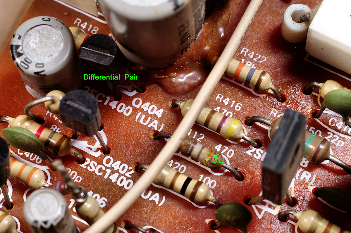

Then removal of the heat sink/amp board. Needed liquid wrench to get the screws holding the heatsink to the chassis free so that I didn't strip the Philips head. I wanted to get a little initial desoldering done in prep for the mouser order to arrive. Once free I could see that it's definitely been worked on before and I may have figured out why the DC Offset is over 100mV. Holding the board up to a bright light source I could see some open solder holes, but on each amp channel, one of the two resistors that feed the differential look bad and not OEM. I did pull one for the left channel and it reads open... So, there will be some more desoldering/testing of components, but I may not need to change out the differential 2SC1400s for KSC1845s. Not that I might not do it some day, but I do want to see if the offset issue was related to the bad resistor(s).
Now to decide whether to go with 464 ohm or 475 ohm in the Dales or use 470 ohm MOX...
R Amp Differential R411 definitely not original, and most likely open.
L Amp Differential. R412 tested open out of circuit.

R411 (the other non-OEM R) is also open.
