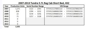

I have many reasons for putting money into this truck and keeping it roadworthy, great street performance in just one of the reasons.
The RCSB is the smallest full-size Tundra that Toyota ever made, and the 4X2 5.7L has the best power to weight ratio with 381 hp / 401 lb-ft in a truck that weighs a little less than 5,000 pounds. 0 to 60 performance with a 4.30 rear gear ratio and 6 speed automatic (4 speeds with 2 overdrives) is consistently 6 seconds. My ECU has a mild tune that boots hp and tq as well as eliminating the speed limiter... the rev limiter is fully functional.
Another reason for me putting money into this particular Toyota truck is it's Unicorn like rarity.
Mine is not a race truck nor is it a show truck, mine is a daily driven sport truck that is a lot of fun to drive.
