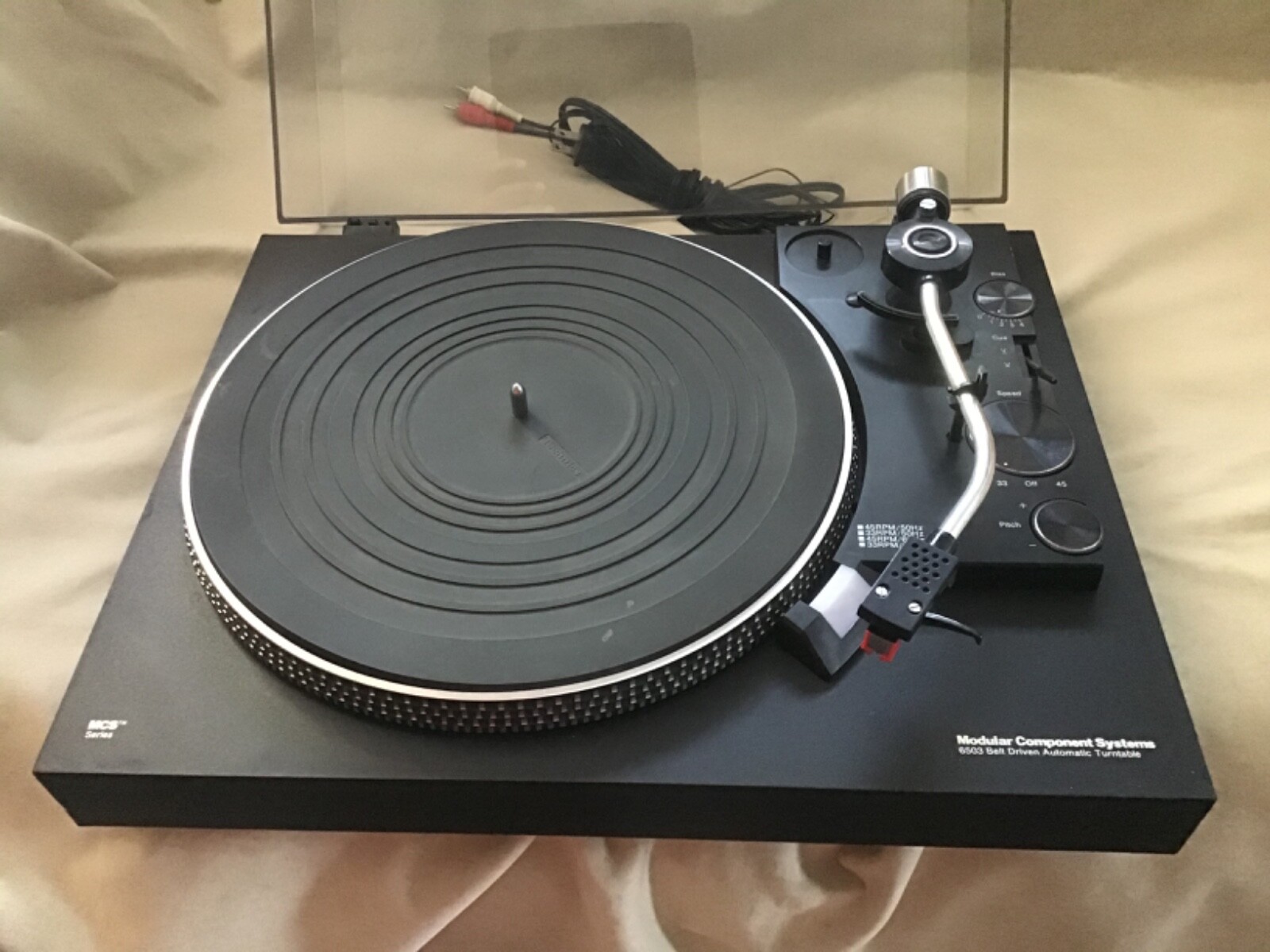

I love listening to vinyl but I'm concerned that I am not getting all I can out of my system. I currently have an MCS 6503, which I understand is essentially equal to a Technics SL-23, and I bought it used from Merle's Record Rack in Orange, CT where Mike there assured me he had refurbished it and everything worked fine.

I have a few questions: firstly, the speed of the MCS turntable, even with the speed dial turned all the way up, is woefully slow. Whether this is a belt, capacitor, oxidation etc. issue is beyond me. All of the resources I have consulted seem to suggest that a basic knowledge of electronics is required to fix this. Should I bring this to a repair shop?

I did not see a manual for the MCS but there is one for the SL-23 which will serve the same. It mentions two adjustment screws for the speed but there's no diagram showing their location. I would look under the platter or the bottom cover. I did see that the pitch adjustment range is only 6% for that table. I normally see 10% with other tables.

Every picture I've seen of the SL-23 shows a removable headshell, which would be consistent with all other Technics turntables I've seen with an S-shaped tonearm. I assume the MCS is the same. It's a perfectly serviceable turntable; but before you start playing with the adjustments, make sure the belt is tight. Remove the rubber mat, then turn the platter so you can see the belt and the motor pulley through one of the holes in the platter. Hold the pulley with one hand to prevent it from turning and try to turn the platter with the other. If the platter turns with little resistance, then the belt is slipping and you need a new one.
i just read that the MCS versions were non-removable and saw a pic. Not the op's table so don't know, but put that out there.

You're correct, and I shouldn't have assumed. There's also one other significant difference, that the MCS only has a single pitch-control knob, while the SL-23 has one for each speed. I wonder if that model was made specific for JC Penney, or it was also sold in other markets.
At any rate, having a non-removable headshell doesn't preclude replacing the cartridge (it just makes it a little more difficult), so I wouldn't replace the turntable just for that; only if it was truly an upgrade in other areas as well.
I just reread the OP, and realized that I missed that the @Duncan L purchased the turntable from a store. If it hasn't been too long, before doing anything, he should go back to the store and ask the seller to fix it, especially as the latter said that it had been fully refurbished.
ETA: hmm, the headshell in that turntable also appears to have very little adjustment for stylus overhang, so yeah, not great...

An update: I called my local stereo repairguy and he advised as I had feared - that to repair the MCS would be more than it was worth. I have no attachment to this piece, and as far as the recommendation about going back to the guy who sold it to me, I'm not in that area anymore and it would be hard to travel there. I can certainly call him and ask but it has been several years. What I do know is that the cartridge and stylus are in good shape. Its the speed issue.
I do have some other turntables floating around - a Dual CS 431, and maybe others. my brothers DJ'd for a bit.
I'm considering just buying a good turntable to move forward with. Changing the cartridges on them is an issue.
Trying to get into the belly of the MCS and adjust it is daunting...

Replacement belts are cheap (I'm reasonably certain that 23.6" is the correct size, but double check before you order). And replacing it is easy. Try that before discarding the turntable.
