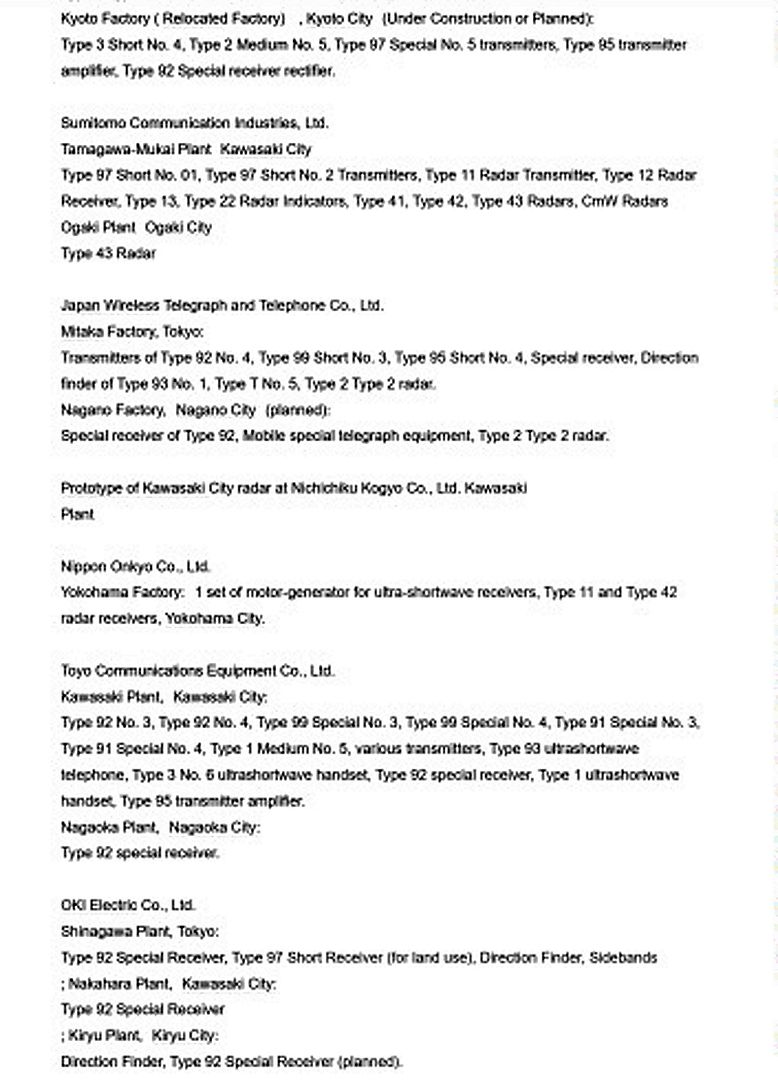

After about 1 1/2 hours of combing through that blog for any info, I've only got one thing that's kind of useful. I went through just about every page dealing with military radio equipment, in hopes that maybe I'd see another one of my speaker in the background, or even better, placed with it's accompanying equipment, but as I've come to expect, nothing. Here's what I found:
14-98 List of Naval Civilian Manufacturing Companies - History of Radio Development in the Imp...png
Where it gives a list of manufacturing companies, factory locations, and what they were making. The quoted time period is "1944 onwards", but no mention of the little mystery speaker. I thought I was on to a lead when going through the blog, and there's a reference to another radio site, this one with an email offered, but that site hasn't been updated since 2012, so I'm not even going to try. So after a few hours of what felt like turning the entire internet upside down, I'm once again back where I started. Thank you @felix_katze for sharing the link for that blog! When I first went there, I thought "If there's a picture of this speaker, it must be here". There's so much info there! I doubt I would've come across it myself. And I even got the idea to search for the untranslated designation, in hopes maybe it was on some Japanese site under that name, and that's why it escaped my searching for so long, but that also turned up nothing. It's crazy to think that this speaker was made in a factory (Probably) and has an official designation and inspection marks and everything. At this point, it seems more like a prototype since it feels like I'm looking for a ghost. But the search continues!
