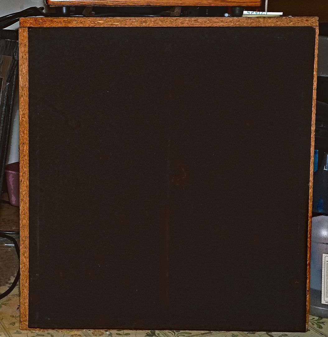

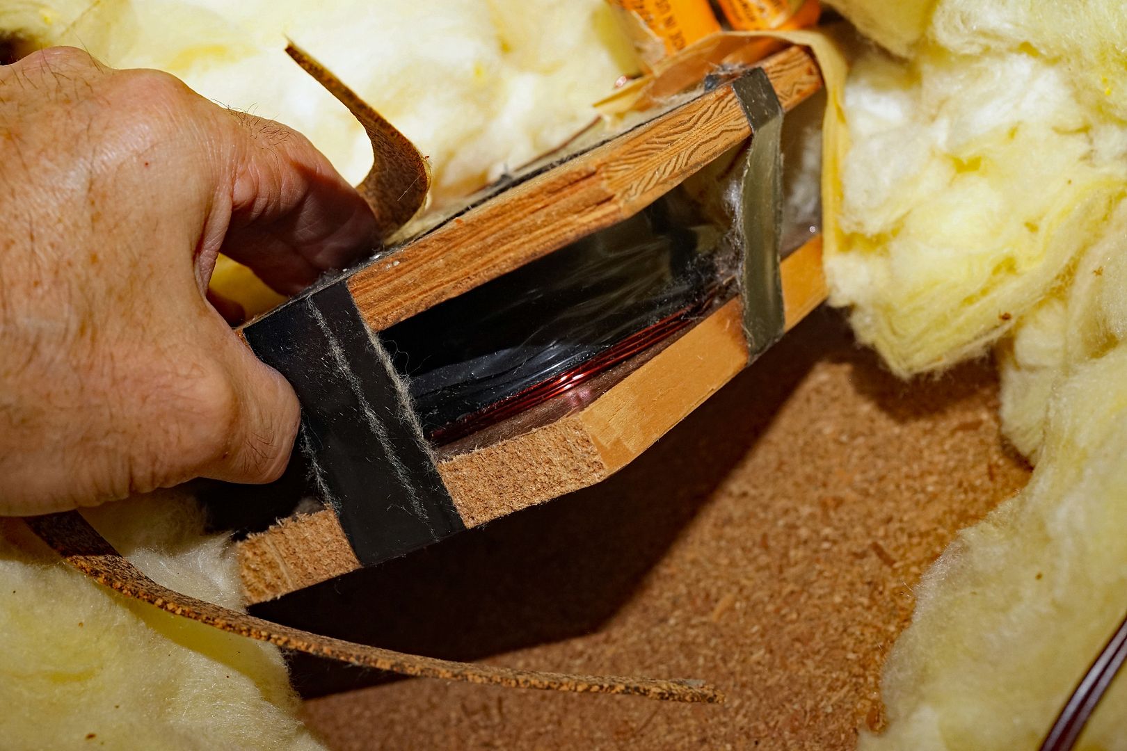

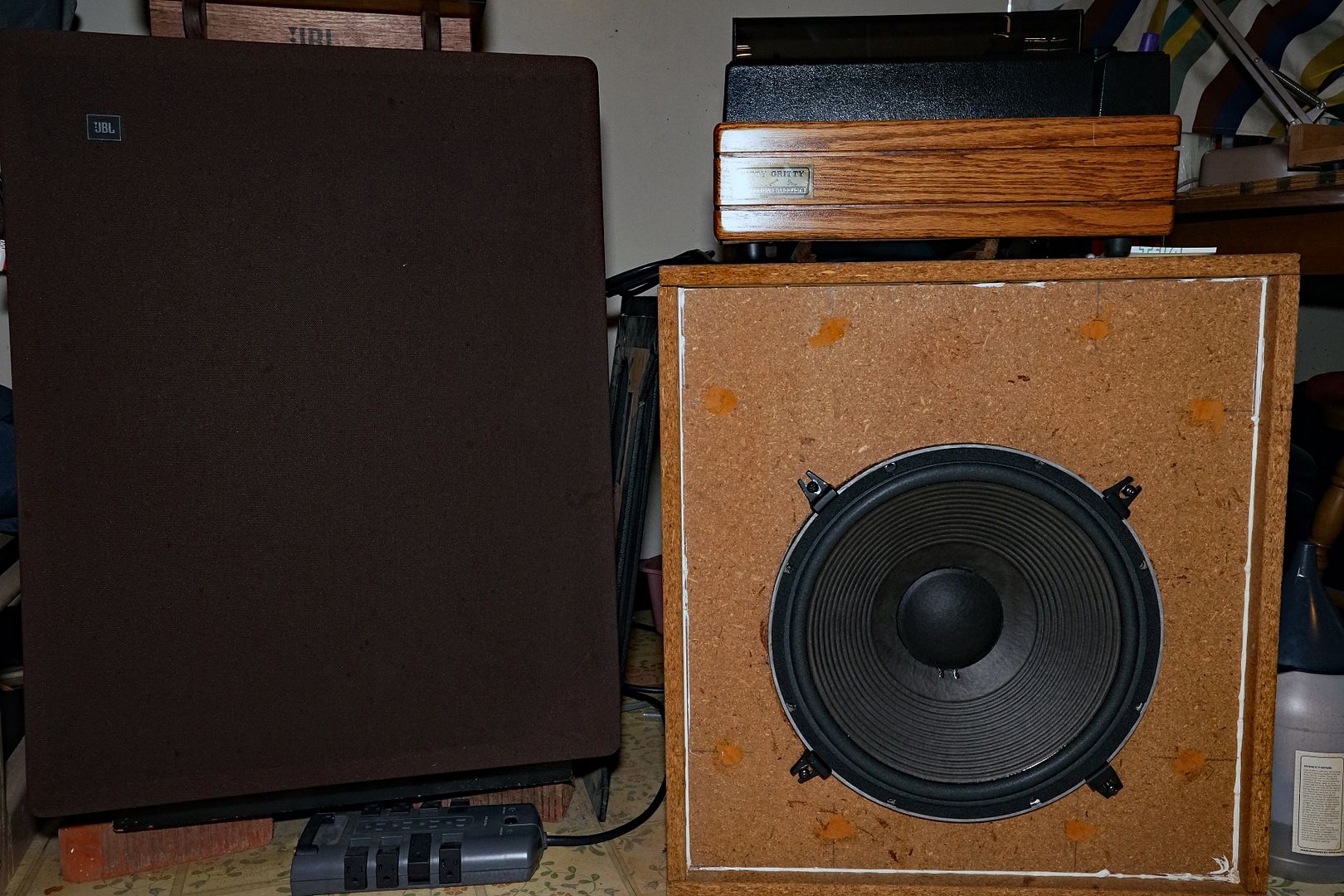

I DIYed two subs using the JBL 136A woofer. 3/4-inch MDF. Bolted internal bracing. Woofer mounted off-center. 4.5 internal cubic feet. 4-inch-cubed fiberglass sound insulation, loosely placed in the cabinets. DIY 12dB/octave passive crossovers. Driven by an Anthem 250 watt/CH amp.
DIY grille.
DIY choke and insulation cubes.
