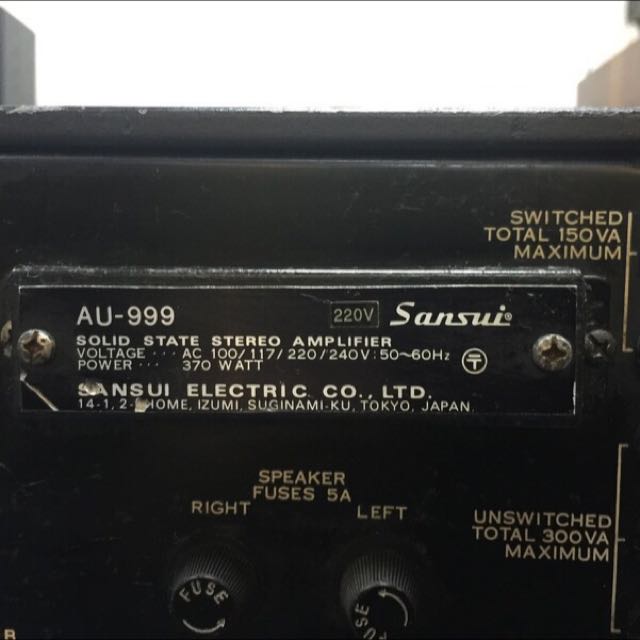

Hello,
I am new to the forum, I have a problem, I have a sansui au999 amplifier in 100v, there is also an international version with voltage selector, but I do not have a selector on my amp, what would be the assembly so that I can put it in 220v?
It seems to me that it is the same transformer
Hello,
Hi, welcome to AK.
if you got a JDM au-999 ,your tag as below, only can use 100v.
if you got the international version,the tag as below and the voltage selection is just behind the tag.
Peter
Welcome to AK :)
As mentioned above by Peter, yours is 100V only.
Your best and only solution is to buy a decent 230V to true 100V stepdown transformer, and NOT a 110~120V version as available everywhere.
Fortunately, we have a very decent manufacturer in the EU....ooooooppssss...... UK......
https://airlinktransformers.com/category/japan-europe-voltage-converters
True stepdown to 100Vac thus.
Me and some buddies have got those, and it is good stuff.
A 750VA version would be good enough for a AU-999, but sometimes folks buy a bit larger version to eventually power more than one 100V unit.
Indeed, for a few bugs more you get a lot more.

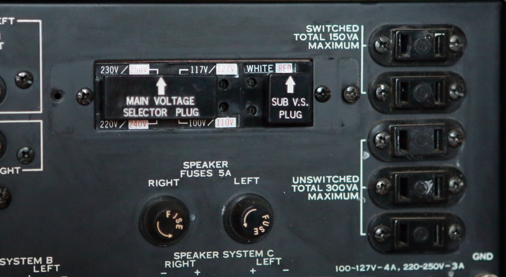

Hi,
This is a query on Voltage selection. The unit is a Sansui AU 11000, and I am fortunate to have a friend in US who helped get this unit to India. Understand that I have to change the Voltage to a 220/240 volts which is the standard here and also replace a fuse with the apt reading. But I am unable to figure out 'how' though I see a selector switch which is currently set at 120 Volts. Please help.
Shoaib
Hi,
Shoaib
H Shoaib,
Pull out the selector, turn the selector arrow to the correct voltage and insert back as shown in the red arrow below.
for 220v
for 240V
