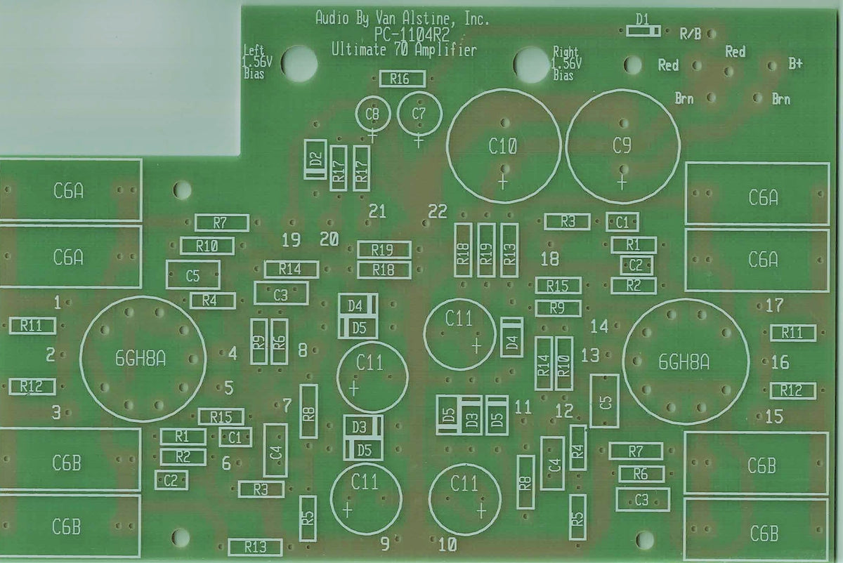

I'm working on this Dynaco ST-70.
It has been modded, does anyone recognize the mods?
I replaced the choke a couple years ago and put in a new set of power tubes. It came back for redplating power tubes after the client put maybe 1000 hours on it.
It had 6H23 preamp tubes in it. They seemed to be a bit microphonic so I ordered a new set of JJ E88CC tubes because I thought they were equivalent numbers. However they don't work properly plate voltage drops down to about 30V (200V with the 6H23 tubes). The sound is then distorted.
There is 30k of plate resistors (2x15k). I tried dropping it to 10k figuring the new tubes were drawing more current and got 60V on the plates. Voltage rose to about 300V on powerup then went down to 60V.
What differences between these tubes did I miss? Can I compensate for them or should I bite the bullet and order a new set of 6H23? Is this a weird design that brought out tube differences that normally wouldn't matter?

6N23P is supposed to be pretty equivalent to an ECC88/6922/6DJ8 so I wouldn't expect significant voltage differences between them. I would also wonder if it was actually designed around those tubes in the first place.
post 14 looks like the same board, just with different trimmers. Per that its supposed to run 6922 / ECC88 / 6DJ8.
not much on the board that would typically cause the output tubes to red plate unless its a bum coupling cap. Might want to check out the bias supply if multiple tubes were glowing.

Maybe, it doesn't specifically call out the tube type but the other posts in that thread say 6922. 6922 = 6DJ8 = ECC88 so I'd expect any of those to have sane voltages. We also have voltages specified so maybe worth comparing what exactly you have vs this for voltage coming into the board as well as what the plates show. Looks like it should be 400-420 volts coming in and the plates should be at 225-250 and the cathode of the "upper" section of the tube at 112-125.
Same drawing, just not cropped wierdly
per this it also should have a regulated supply, not sure what that looks like but I do see some extra stuff underneath that looks to be more than just the usual handful of caps and resistors that would sub for the old can cap.
I see at leased 11 diodes, wow! Personally I would strip it out, either get a stock style board kit from Dynakit, or a boars kit from 4ubes4hifi that us3sbeither three 12AU7 tubes and also has CCS. shecematics and assembly instructions for both style amps are available.
