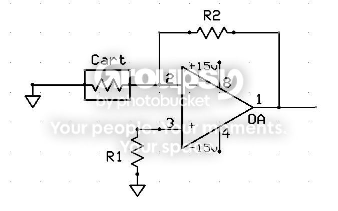

R1/R9 won't make any difference, they are just there to balance out the op amp inputs, they have no effect on the actual gain. That's set by the difference between the carts internal resistance and R2/R10.
Look at the feed back loop on an op amp there is a resistor that goes from the inverting input to ground, the carts coils take the place of that resistor, so in fact it's part of the feed back loop and is fixed. The only way to increase the gain is to alter the value of the resistor (R2) that goes between the inverting input and the output of the op amp.

I'm not worried about the gain -- turning the volume up to 2 o'clock gets me full listening volume. I used to get that at 12:30 on the dial, but unless there is a compelling reason to change R2/10, I'll just leave it.

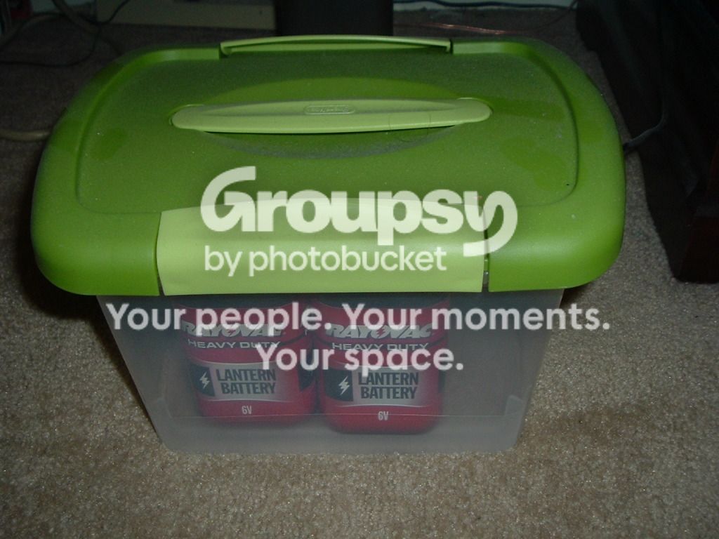

Well, at least I took some photos of the outside. When I get my new AT-33EV I'll have to open it up to change the resistors, so I'll take a shot of the insides then.
I mounted the batteries on the outside for easy monitoring and changing. I may try lantern batteries next, depending on how long the 9Vs last.

Your build looks great.
You're not imagining it, capacitors, op amps and most electrical components sound better with use, I say it usually takes at least a couple of weeks of use for it to really sound it's best.
You will notice a fuzziness to the sound when the batteries get low, definitely switch over to the 4 x 6v lantern batteries, they will save you a fortune for a start. Besides the benefit of having 12volts per side instead of 9volts.
I get the RayoVac twin packs from the camping section at Walmart for around $5.00 a pair and they will last a year or more.
Yeah, I'll score some lantern batteries soon.
