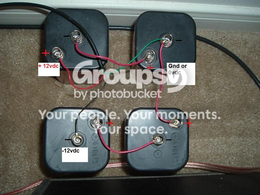

Upon play back, I get a a micro second of sound, then cut out/silence. I used 1K ohm resistors for R2/10 per the calculator, but as Phillip predicted that may be too much. Going to swap in 660 Ohm next. Had to try the high gain first, as a constant, nagging problem of my Deonon DL-103D has been low output and an overworked amp.
Here's how to connect up the 6v lantern batteries.
The Red wire is the Positive connection, the Green wire is the Ground and the Black wire is the Negative.
I get them from Walmart in the camping section, you can get twin pack Rayovac's for around $5.00 per pack.
Never connect the batteries without the center (0v) ground connection.

You cannot use one 9v battery like you show in your picture above, you must use two and have the center tap as the virtual ground, 0v.
This is how you connect up the 9v batteries:
If you are using the AA's you must have SIX per side and wire them to have the center tap as well, this design must have a positive, negative and ground supply to work. I would use EIGHT per side, using two of the adapters wired like the 9volt batteries.
I twisted the jumpers from the batteries to make twisted pairs, and that got rid of most of the interference. There was still a little, but when I pushed the batteries all together until their cases were touching, it all went away. It came back when I separated them. Weird. There really is a huge transmitter about a quarter mile from here though. A "modern country" station that infects all my components without effort to eliminate it.
Sounds great now though. Better than with the 9V batteries. It seems bigger, more solid, and more dynamic with the lantern batteries. Just to be sure, I will probably solder shielded cable directly to the batteries, instead of the unshielded alligator clip leads I have now.
