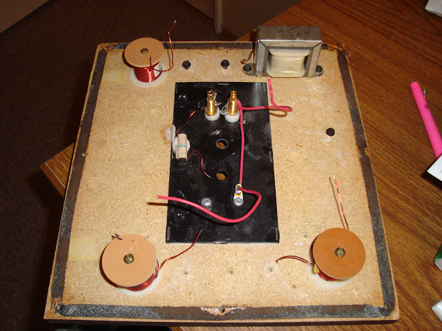

as Jonesy mentioned, we're going to make the II's biampable. we're using my spare XO boards and mounting the rebuilt upper circuits on them, with the plan of ultimately resting these boards on the top of the woofer cab - sort of a poor man's version of Maxamillion's IIb external XO project. the inductors were moved to the corners for isolation, and each corner will also have a padded standoff so it can be laid down and connected to the drivers via short runs of Kimber Kable. meanwhile, the electrolytics for the woofers will be replaced in the original board, and the connections for the upper circuits will be disconnected so they have no residual effect whatsoever. the starting point for the new crossovers:
and here's the basic mockup. in the gap will go a barrier strip for connections to the drivers.

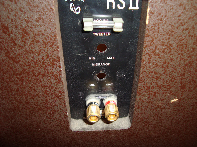

Well, everything is finally back together and the verdict is........
No freaking right tweeter output! :dammit:
I've swapped all the EMITs from rear to front and left to right. The right EMITs just aren't firing. A cursory comparison between the left and right XO's didn't reveal anything out of the ordinary. No obvious loose connections, shorts, or bad solder joints. I'm totally stumped.
:headscrat
The left sounds great!
crap. i didn't have any spare drivers to test the XOs with before i shipped them back, but i triple-checked the wiring and didn't see anything weird. originally there were some major wire-routing differences between the two when i found a better way to do the second one, but i went back and made them essentially the same. can't help thinking it still must be something i messed up, though. :scratch2: do you have a DMM with continuity-testing mode? that's a first step to doing comparisons between the left and right tweeter circuits. the layout is simple: from the positive post to the fuse (have you checked that?), then to the 12uF cap marked "T", then it branches with the teeny inductor shunted to the negative post and the other wire going to pot and then to the tweeters, with the return wire from the tweeters going back to the negative post.
