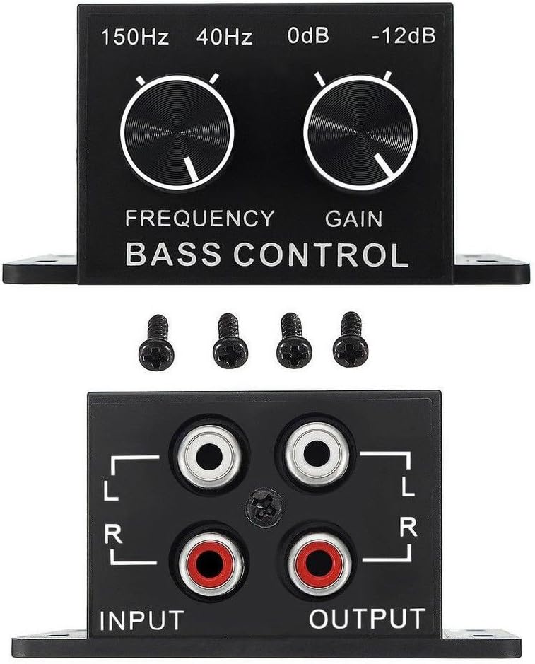

If the 140hz fixed crossover does prove to be too high (which is likely but not certain till you try it because crossover limits are not always accurate and I think 140hz was actually expressed as the upper frequency response for the sub rather than specifically saying that is the crossover point -- the crossover might actually be lower, which would still have some rolled off output at 140hz) -- then the inexpensive passive sub control I posted in post #8 can be inserted between the Yamaha sub out and the Tannoy left or right RCA in to reduce the crossover frequency.
