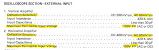

ok so im gonna have to look into this a bit more because im not sure how I would hook up my turntable to the scope input jacks. and as far as the external audio signal range, im not sure what the turntables ranges are. I have a pioneer pl518.
Your turntable does not connect to the scope input jacks, it is too low a signal level and need equalization.
  • Connect your Pioneer PL-518 turntable to the 3300 phono jacks as you normally have it connected and set your selector for phono
  • Connect one set of the Tape Out jacks on the 3300 to the Scope Input jacks of the Model 120
  • Press the External scope display switch on the 120 to select the scope to show audio on the scope input jacks
  • You should be able to see the "scrambled eggs" pattern on the scope when you play anything on the 3300

What I am not sure about is the maximum signal level to the 120 scope input jacks? Also, I don't see a max voltage on the Tape Mon outputs on the 3300.
  • The SM shows this:
  • But, in another paragraph (as @kwayde points out) the OM shows this:
