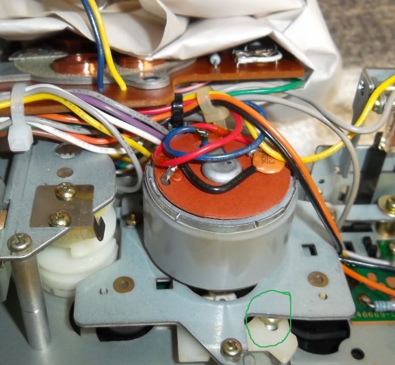

I was gonna ask you if you still remember, What is that spacer that looks like a nut sitting on the bx-300 reel plate for? it was just like sitting there and not even screwed on?
