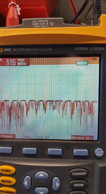

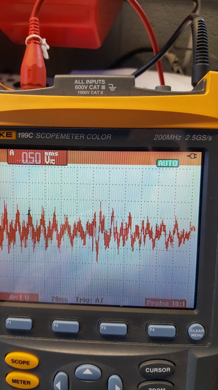

This is my friends amp and it has been setting for a few years. There is no output other than static and the occasional popping sound from the outputs. The left side is worse than the right but no output from either when sending input into the aux input. With the output turned down I have checked dc voltage across the speaker outputs with a scope.
A R -20 mV L -144mV
B R -7 mV L -100mV
My next step was going to check the transistors in the Power Amplifier section? Any recommendations on where to start with this one???

Static appears to be from pre amp section, It seems to have diminished with more use but definitely gone when jumpers are removed from the PRE-OUT/MAIN-IN section.

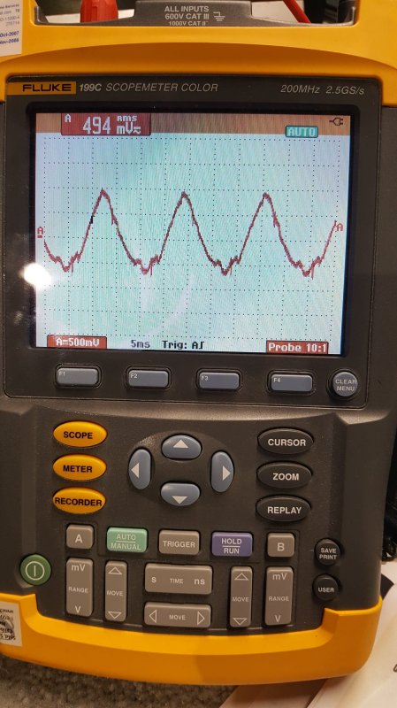

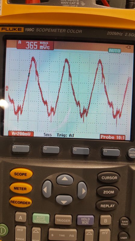

That solved one of my issues. I have a intermittent source switch, I have deoxed it but it is still a little flakey. Once the source switch is working properly I have output from right speaker only. I measured output with scope at speaker terminals and attached pics.

The Output Left trace suggests you should be getting something out of the left channel though it will be distorted.
Looks like the positive half of the amp has failed or is prematurely clipping.
