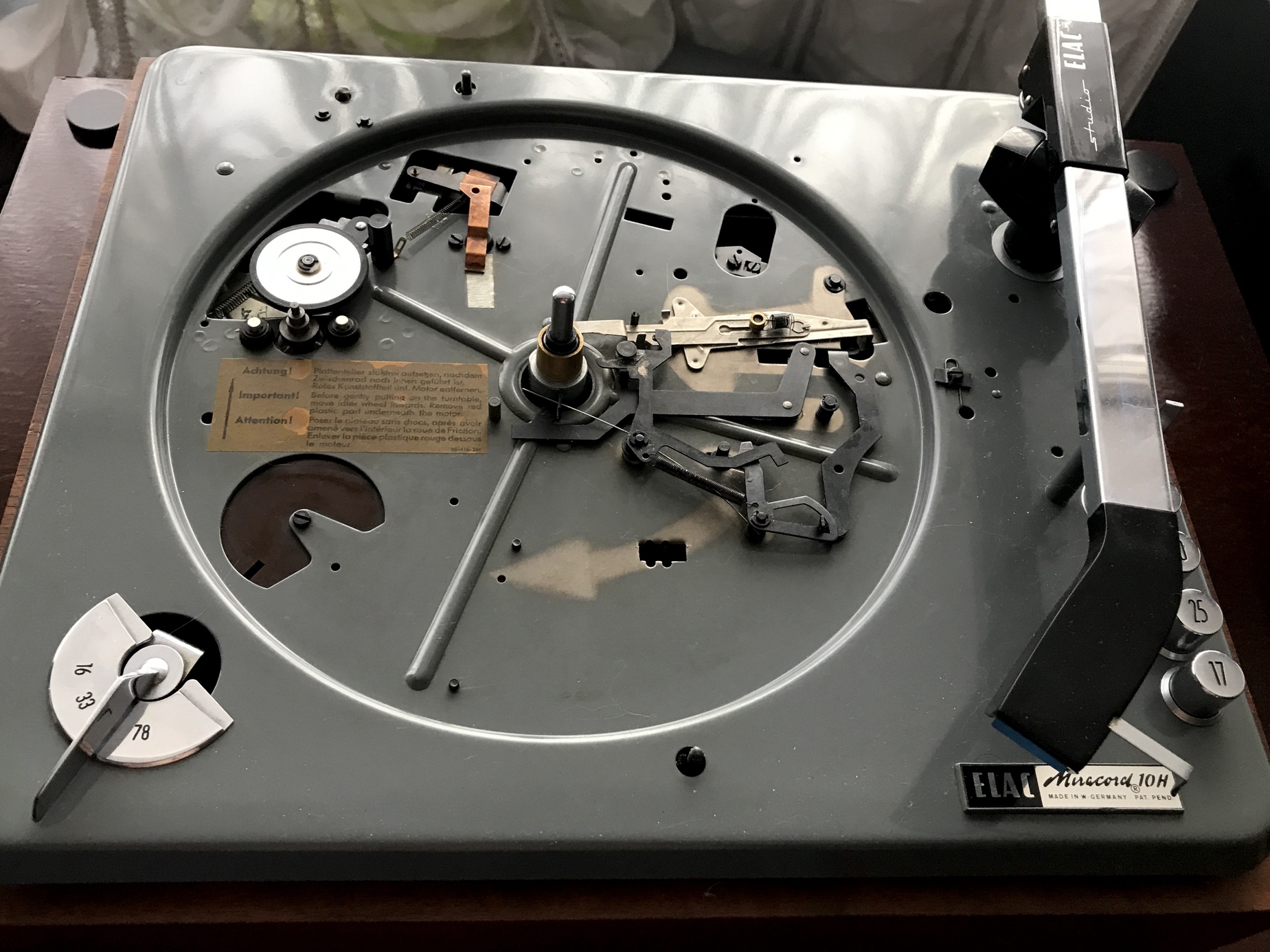

I think I have something blocking my spindle hole (Elac 10h)
red888
Active Member
I had fun writing that title, anyway I got an Elac 10h recently- I'm totally new to turn tables.
I got a stacking spindle on ebay which said it came from a Miracord 46. I only had the single play spindle.
When I inserted the stacking spindle it was super wobbly and did nothing when I stacked records and tried to play them. Now I initially thought my single play spindle was also kind of wobbly but assumed that was normal because it still played records. Although, even when the single play is inserted right-side up it replays forever. I read this was a common problem and I had to fiddle with some clip or something, but maybe its because of an obstruction?
I pulled off the platter and took some pictures. Does this look right? Pics I see online seem to show the spindle coming out the bottom but I don't see that and there is some white plastic thing in there. Inserted does it look like its coming up too high? The pic of the underside is with the spindle inserted. I also took a pic of the hole, you can see the plastic looking thing.

It looks identical to the ones I see for the 10h. The little pokey thing seems to have nothing to go into which I think is why its so wobbly. I also think the single play spindle is suppose to come out the bottom too? Otherwise how do the mechanisms like catch and interact with it?
And photos I see around the web seem to show the spindle going in deeper and coming out on the bottom
ELAC 10, 40, 45, 50 spindles
yes, they are supposed sit below the platter spindle and rest on the lever
Any idea what the white thing could be and how I can get it out of there? The table is screwed into my whole stereo cabinet I'd like to not have to remove it. Can I just poke it through from the bottom?
I'm wondering if it is a broken piece or something. When I compare my table underside to those on the web it seems to have all the same stuff in there though.
HA! I poked it out of there. Clearly it seems to be the top to what was probably the original changer spindle.
They probably put the changer in upside down, got that plastic piece stuck and threw out the changer and kept the single play one.
Everything does! Just tested, single play stops when right side up and the changer spindle works as it should as well.
