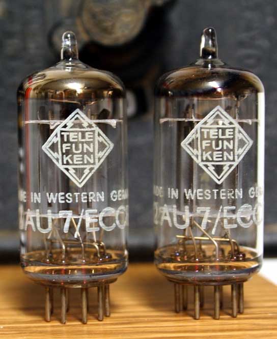

Problem with Telly tubes is the label turns to powder if you just look at em cross-eyed ...
These look almost virgin ... so they're probably counterfeit ... ;-}
They sound good though, so I can live with that.

I'm told that genuine TF's do not have a perfectly round getter, they have a little 'bend or notch' where they attach to the getter post. Fake ones do have a full round getter. Not sure if that's true but interesting.
Mine have the notch, so they're either genuine ... or a really good fake ... ;-}
Some of these counterfeits are pretty good though. I got some "Bourns" pots for an insanely good price a while back that would probably stand up to microscopic examination, and they even track properly. They included the graduated 10 turn knob, which normally sells for about what just the knob usually sells for.
