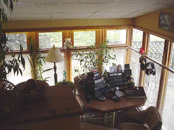

That’s why they made something called a dry-vac to suck up and remove water from where it doesn’t belong. Then of course there are hurricane shutters installed on hinges to close in front of the windows so the don’t break. With the increase of severe weather people need to be more prepared to deal with nature before hand and not after the fact.
Built a sunroom on the back of the house that has the old school house type windows at the top of a glass wall.
Eaves are also extended, so it would take more or less hurricane force winds to drive any rain inside. Any water that does get past the openings hit the glass and rolls down outside. No worries about the radio equipment getting wet. Great ventilation too - I'll leave those open when I'm gone for a while and close everything else. Well, not everything - I also have a skylight in the shower, but water isn't much of a problem there ... <G>
^^^Cool little operating position.
@sKiZo You don't want that Turner Super Side Kick +2 getting wet. ;)
(Can't tell if that's a Swan, Heath, Cobra or Dosy in there too.)
