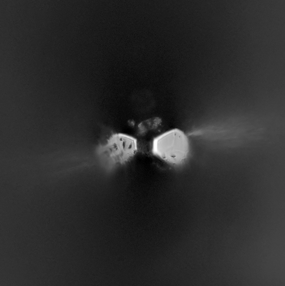

From above this looks something like this, where you can see both wearpatches on the side touch (quite badly here...)

Sumiko Blue Point Special with logged 3700 hours of play the stylus has been riding bottom for so long it formed a "screwdriver" shaped contact patch. The flat part of the tip is so wide that the SRA can be accurately measured, at 96deg. There is significant imbalance between the contact patch wear, with left contact much more worn than right, but it was played on an air-bearing Linear Tracking arm so the imbalance was presumably not caused by Anti Skate forces.
The contact lengths are very long, 0.93 mil and 0.78 mil, about 3x the max length for full FR reproduction. I can't imagine this cartridge sounded very good, and it may have done a lot of damage to the records it played.
I made the composite image below with tip shot by ringlight. I also took the image with the Shure method and will include it below. The Shure image does not show the extremely close contacts as they appear in the front view for some reason, but I am including it for completeness. It certainly shows the large/long contacts.
My impression of a worn stylus is that it will have a sharp edge or edges at the boundaries of the wear pattern, and those edges will act as chisels to damage the record grooves.

The "FLATS" you see in these pictures are the actual point of contact or point of Wear between the Needle and LP record groove walls.
The bigger they are the lower in the groove the needle sits and the worse the tracking or ability for the needle to follow the squiggly groove walls.
