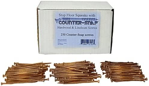

Some earlier mention of fixing the floor and I agree - that would be a good start. And if as suggested earlier it's the joists themselves bouncing around - I'd think that a few skips are the least of your problems.
Also, what the co-op gestapo don't know, right? These snap off screws are killer for securing loose flooring, and pretty much invisible when done. You can also screw right thru carpeting. Easy DIY project too, and the only tool you'll need is a drill and bits ...
