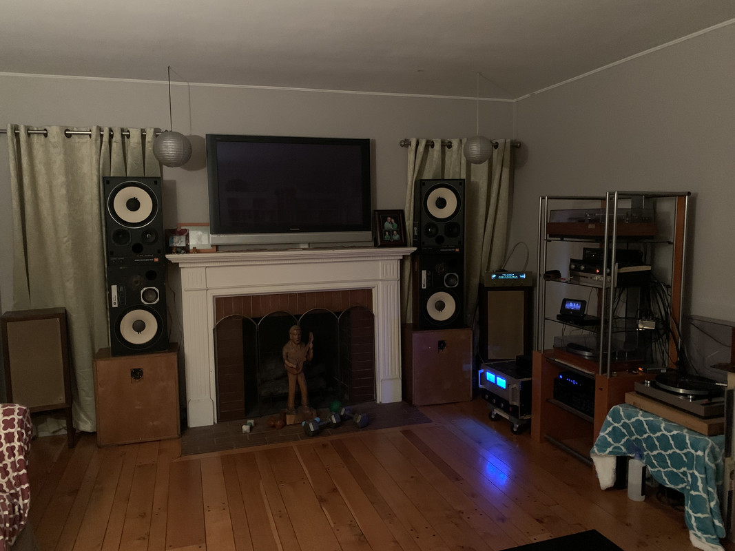

Hell I'm constantly experimenting with lots of speakers and limited space. I do things which most would look at and shake their head(lots have) and yet as long as it sounds good to me and doesn't bother the spouse(much) I fly with it. Until I get a antsy again and switch things around, moving things in and out, stacking, pushing into corners, against walls, into the room, etc.
Here's my latest layout, with a couple of JBL's stacked vertically for space saving(I'd rather have them horizontal both for looks and sound) and the AR3's pushed into the furthest corners. Incredibly, they sound amazing like this. In the old days AR3's were shoved into top shelves of bookcases, high up and horizontal, and that was OK. I've had them long enough to know that while they certainly react as much as most speakers to placement, there isn't much you can do to them(or the JBL's for that matter) that can actually make them sound bad to ME. And that is all that I really care about.
