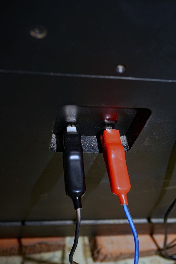

So I've been thinking and it seems the stock cable posts are a little weird and do not look like they will work with my cable spades. It also looks like the gauge of the cable is considerably smaller than my 10 gauge wire. Any ideas on how to deal with this?
I did not want to change-out the OEM posts. This is what I've been doing the last 5 years.

On my L100A and L65As I kept them as-is, I just used wire with a "speaker pin" termination. Not a great terminal nor a great way to terminate IMO, but I wanted to keep the speakers original.
I finally gave in on my L300As, remvoved the plastic twist-lock terminals and installed nice big 5-way binding posts so that I can use banana plugs. They go through the same holes so no drilling or altering the cabinet, attach to the ring-terminals inside, and kept the original terminals.
If I ever decide to re-install the original terminals it'll mean removing the woofers to do so, but they can be reverted to completely original, and I get to enjoy using my real speaker cables and not fussing with those silly little plastic ones, I'm very happy I converted them.
I suggest converting to binding posts / banana plugs and just keep the old terminals, well worth the time.
