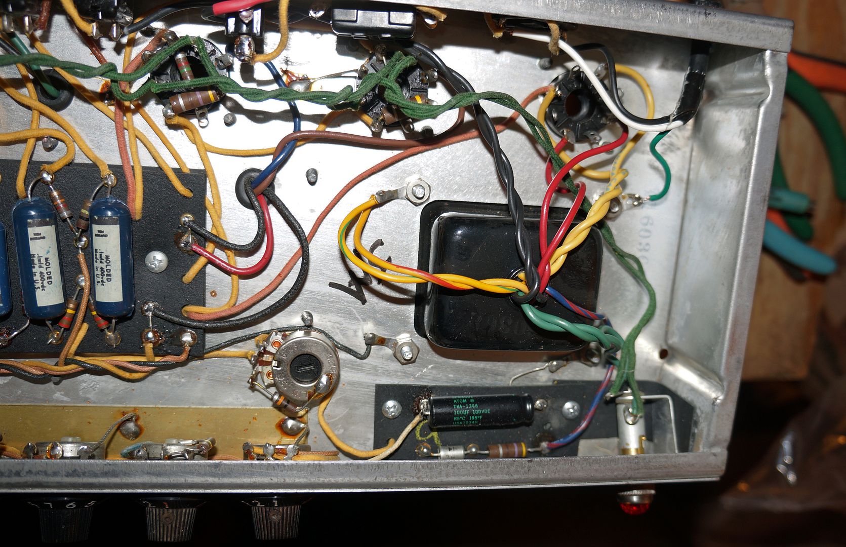

Looks fine. Make a nice, thin layer of solder over all the exposed twisted copper wiring. Especially at terminals. This will keep the leads from unraveling. Maybe, heat shrink insulation might have been a nice touch. Like what I did on the fuse holder, in photo. You can also just see the red shrink insulation on one of the power lines, above the fuse.
(Click onto image)
