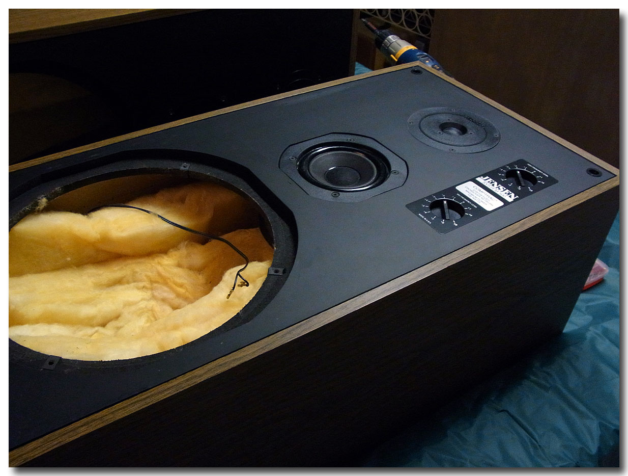

These are interesting speakers - at first they look like your typical acoustic suspension 3 ways with L-pads for highs and mids. But - turn them around and you find another tweeter - similar to System B and C Jensens.

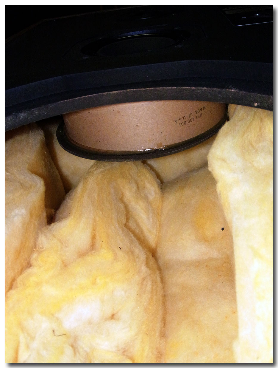

After taking the woofers out for refoam, looking inside the cabinets you can see that Mid driver has it's own large enclosure. :

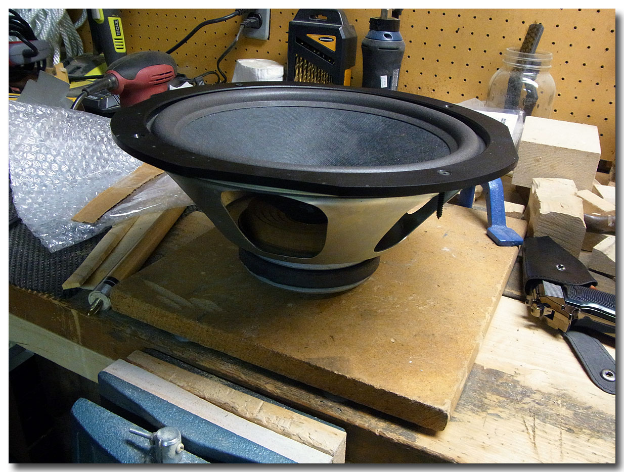

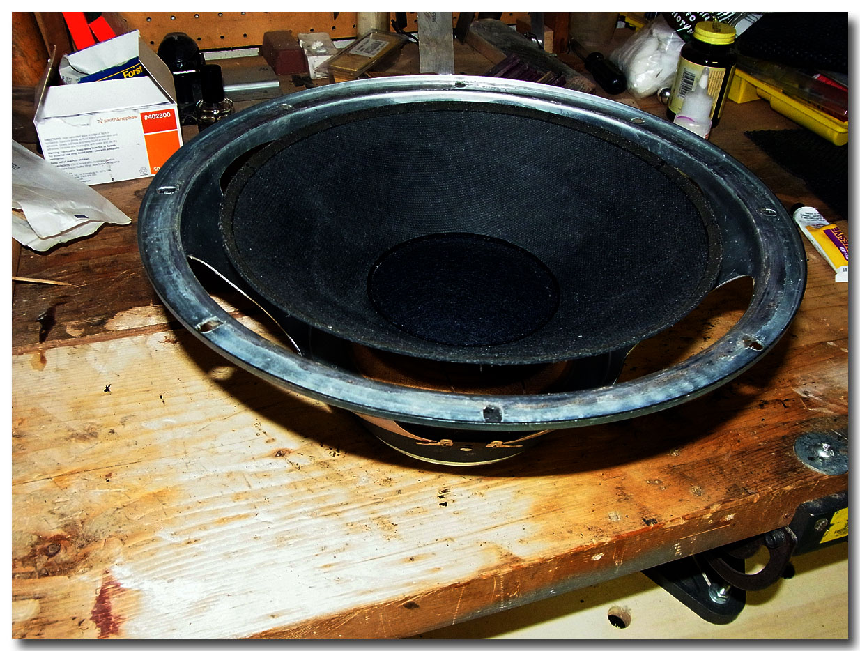

Woofers themselves to me look like your typical drivers ( I dont really have much experience on this subject)
Front positioned L-pad remind me of those on Realistic Mach speakers:
Overall - its a solid, heavy well made speaker.
Well, refoam is done:
